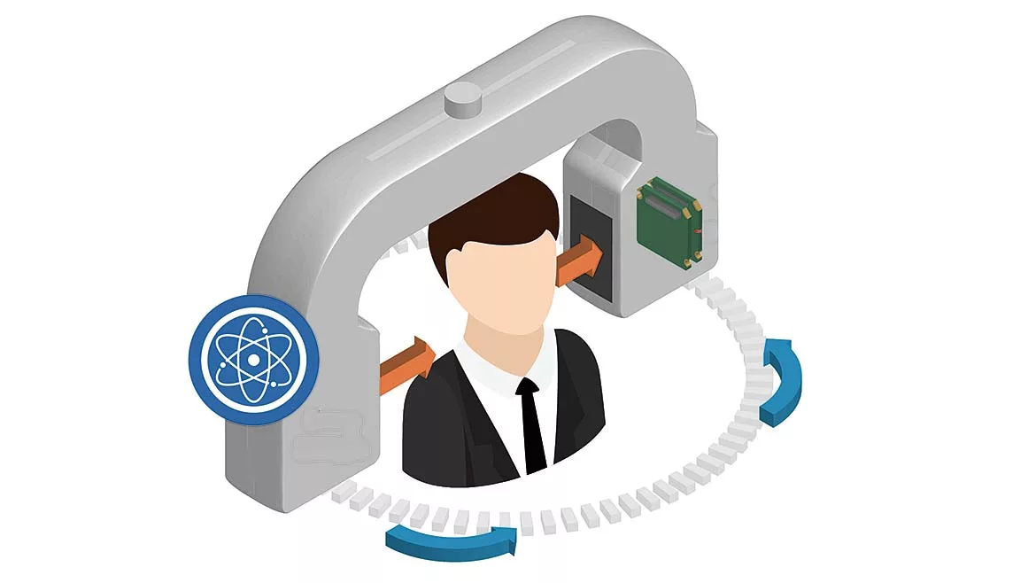

Dental X-ray feature image
Image Source: Pleora

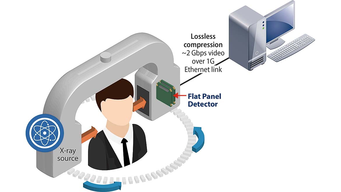

Similarly, dental imaging is adopting compression techniques as it evolves from still X-ray to more complex 3D applications. Panoramic radiography, or panoramic X-ray, uses small doses of ionizing radiation to capture the entire mouth in a single image, including teeth, jaw structure, and surrounding tissues. Unlike intraoral X-ray where the film is placed inside the mouth, a panoramic X-ray machine consists of an X-ray tube mounted on one side and an FPD on the opposite side. During the examination, the X-ray tube rotates in a semicircle and projects a beam through the patient onto the FPD.
The FPD integrates embedded hardware supporting 1 Gbps image transmission – along with metadata, power, and control data – to processing over low-cost Gigabit Ethernet. As imaging performance demands increase, maintaining the cost of the network infrastructure plays a key role in total system cost advantages for solution providers.
To boost the capabilities of the existing Ethernet infrastructure, the mathematically lossless compression hardware acceleration approach transmits up to 1.5 Gbps throughput rates over existing 1 Gbps infrastructure. The compression technique ensures original and post-compression data are identical while supporting ultra-low latency performance for real-time dental imaging.
Dental panoramic X-ray systems
In dental panoramic X-ray systems, lossless compression enables flat panel detectors to transmit high-resolution, real-time video at ~2 Gbps over standard 1 Gbps Ethernet links. This ensures diagnostic image quality while reducing infrastructure costs. Image Source: Pleora
