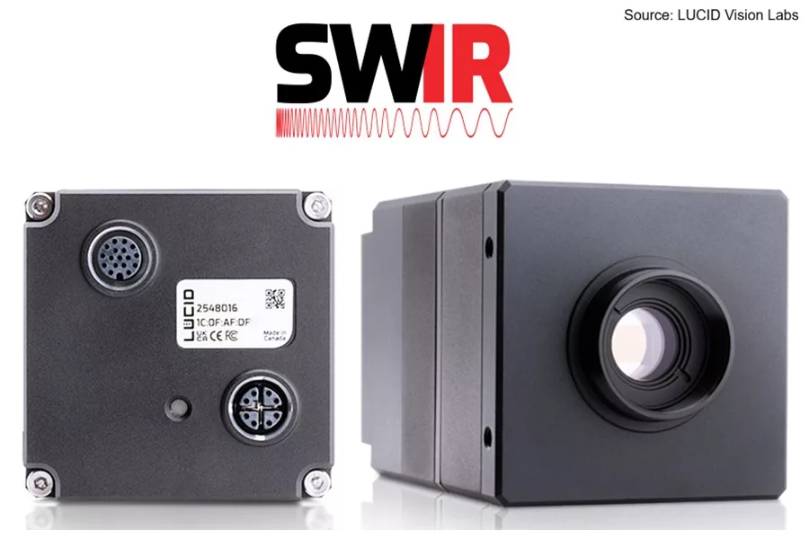

LUCID Vision Labs, Inc. announced the launch of the Atlas10 SWIR, a high-performance 10GigE camera with RDMA support featuring Sony’s 5.2 MP IMX992 and 3.2 MP IMX993 SenSWIR InGaAs sensors with integrated thermoelectric cooling for enhanced image quality and reduced noise.
The Atlas10 SWIR captures high-resolution images across both the visible and short-wavelength infrared spectrums. With a compact 3.45 μm pixel size, the SenSWIR sensors deliver excellent detail and high sensitivity, making the camera well suited for semiconductor inspection, food and agricultural sorting, medical and life sciences imaging, material identification, and packaging inspection.
The Atlas10 SWIR features an integrated thermoelectric cooling (TEC) system, designed to maintain a stable sensor temperature during continuous operation. By actively regulating the temperature, the Atlas10 SWIR reduces dark current and minimizes image noise, enabling consistent, high-contrast SWIR imaging in demanding thermal environments. The cooling system is supported by an internal heatsink and thermally optimized housing for reliable operation with a case temperature of -20°C to 55°C.
The factory default temperature set point of the TEC is 20°C, but for users who require maximum image quality, the temperature set point can be lowered down to 10°C. An optional external heatsink can be attached for additional heat dissipation and is included with the purchase of a Atlas10 SWIR camera. For applications prioritizing power efficiency, the TEC can be disabled to reduce overall system power consumption.
“The Atlas10 SWIR combines high-resolution Sony SenSWIR technology with advanced thermal management and 10GigE performance,” said Rod Barman, President at LUCID Vision Labs. “By integrating thermoelectric cooling directly into the camera, we enable our customers to achieve stable, low-noise SWIR imaging in demanding industrial environments without compromising on speed or flexibility.”
The Atlas10 SWIR features LUCID’s Factory Tough™ IP67-rated design for protection against water, dust, shock, vibration, and electromagnetic interference. Equipped with a 10GBASE-T interface, it delivers data transfer rates up to 1,250 MB per second over standard CAT6a or CAT7 cables up to 100 meters, simplifying system integration without requiring frame grabbers.
The Atlas10 SWIR RDMA cameras conform to the GigE Vision 3.0 and GenICam standards and are supported by the Arena Software Development Kit, compatible with the Windows, Linux 64-bit, and Linux ARM operating systems and the C, C++, C#, and Python programming languages.
The Atlas10 SWIR models ASX033S-WC (3.2 MP) and ASX053S-WC (5.2 MP) are now available for order.
