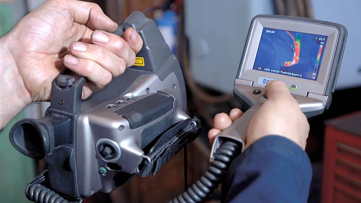

The device in the image is a FLIR Systems ThermaCAM S60 infrared camera.
Image Courtesy of RWE/BINDT
