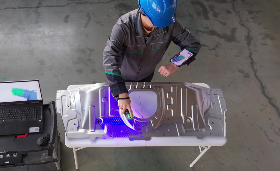

Operator using a handheld 3D scanner to capture surface geometry of a metal component for dimensional inspection, reverse engineering, and quality control.

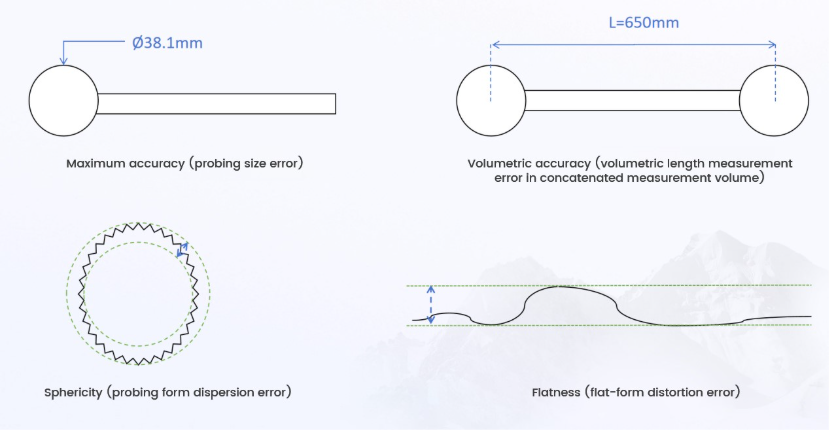

A 3D scanner is only as useful as it is accurate. And accuracy, it turns out, is far more nuanced than a single number on a spec sheet. The international standard ISO 10360-13:2021 defines a rigorous framework for evaluating scanner performance — think of it as a full medical examination rather than just height measurement. Four core metrics form the foundation of this evaluation, and understanding them will make you a far savvier buyer, operator, or engineer.
1
Source: SCANOLOGY

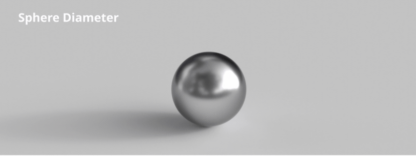

Max Accuracy — How Accurately Can It Measure an Object’s Dimensions?
This is the most fundamental test: scan a precision reference sphere and compare the measured diameter against its nominal value. The gap between those two values is the accuracy.
2
Source: SCANOLOGY
A smaller accuracy value means the 3D scanner is giving you diameter readings closer to ground truth. It’s the baseline check — the equivalent of verifying that a ruler starts at zero. Without this, nothing else you measure can be trusted.
Why it matters: In quality control for machined parts, even a small deviation in diameter can mean a component falls outside tolerance. This metric is your first line of defense.

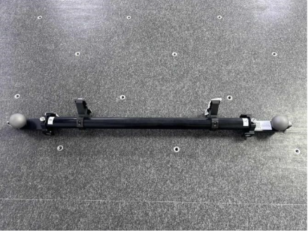

Volumetric Accuracy — How Precisely Can It Measure Distances in Space?
A scanner might nail a single measurement but drift as distances grow. Volumetric accuracy tests whether the scanner maintains geometric accuracy across its entire working volume — not just at one point. It reflects the difference between the length a scanner actually measures and the true, nominal length of the object being scanned.
3
Source: SCANOLOGY
The standard test places a calibrated ball-bar (two precision spheres on a rigid rod) in 12 different positions and orientations within the scanner’s field of view, measuring the center-to-center distance each time.
Why it matters: When scanning large workpieces — aircraft fuselages, automotive body panels, large industrial assemblies — you need to trust that a point at one edge of the scan aligns accurately with a point at the opposite edge. Volumetric error tells you exactly how much drift to expect.

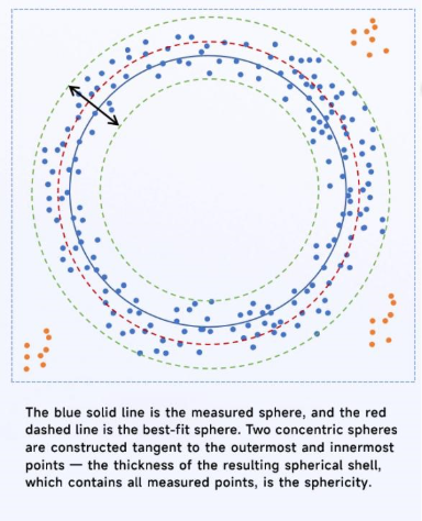

Sphericity — Can It Capture the True Shape of a Surface?
Sphericity illustration
Source: SCANOLOGY
Here’s where things get genuinely interesting — and where many spec sheets fall short.
Sphericity measures how faithfully a scanner captures the shape of a surface, not just its size. It’s calculated from the thickness of the thinnest concentric shell that can contain all the scanned surface points. A perfect sphere would score zero; real scanners always produce some value above that.

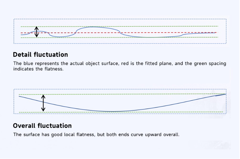

Flatness — Can It Tell You If a Surface Is Truly Flat?
Flatness error is the measured deviation between an actual surface and a perfectly flat reference plane, introduced during machining or manufacturing. Simply put: the smaller the value, the smoother the surface. It captures the full picture of surface variation — from fine-scale irregularities like tiny ripples to large-scale distortions like end-to-end warping.

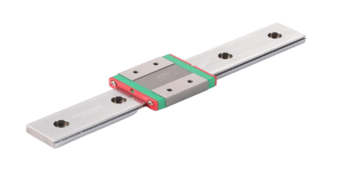

Why It Matters: Take a linear rail as a real-world example. When flatness error is high, the rail surface becomes uneven, creating excessive friction during sliding and putting strain on internal components. Over time, this compromises both workpiece stability and dimensional precision — exactly the kind of outcome precision manufacturing is designed to avoid.
Linear rail example
Source: SCANOLOGY
The Bottom Line: The lower a scanner’s flatness value, the more accurately it reflects the true condition of functional surfaces. That means more trustworthy scan data, better-informed decisions, and fewer costly surprises downstream.

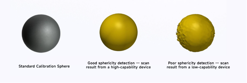

Accuracy Doesn’t Guarantee Sphericity Performance
A 3D scanner can achieve high-accuracy results while still producing a poorly shaped scan. As illustrated below, a 3D scanner with strong sphericity detection captures a reference calibration sphere that closely resembles its true geometry. A 3D scanner with weak sphericity performance, however, may produce a significantly distorted shape — yet the software-fitted sphere diameter can still look perfectly accurate. This means accuracy alone doesn’t reveal how faithfully a scanner reproduces real surface geometry.

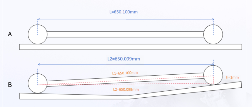

Volumetric Accuracy Doesn’t Guarantee Flatness Performance
The same principle applies to volumetric accuracy. When scanning a ball bar to measure the distance between sphere centers, assume Scenario A represents the true geometry. A scanner with poor flatness control may produce Scenario B — where the bar appears to bow upward by 1 mm. The measured center-to-center distance remains nearly identical (A = 650.100 mm, B = 650.099 mm), so volumetric accuracy looks fine on paper. But the flatness deviation is significant, and the resulting scan model diverges meaningfully from reality.

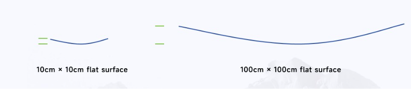

Less Error Accumulation at Scale
The tighter a scanner’s overall accuracy control, the less error accumulation occurs when measuring larger parts. Take flatness as an example: scanning a 10 cm × 10 cm flat surface versus a 100 cm × 100 cm flat surface of the same shape — as the size scales up, the flatness error scales up with it. This means a scanner with a smaller baseline flatness value will naturally produce smaller accumulated errors when moving to larger workpieces, keeping measurements reliable even as part size increases.

Technician using a handheld 3D scanner to inspect a metal automotive component, capturing dimensional data for quality control and manufacturing verification.
