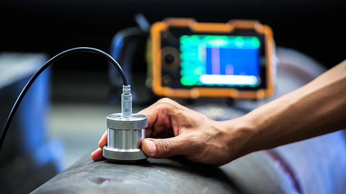

Technician performing ultrasonic testing on a metal pipe with a handheld probe.
Image credit: kimtaro / Getty Images (Creative #490726620)
