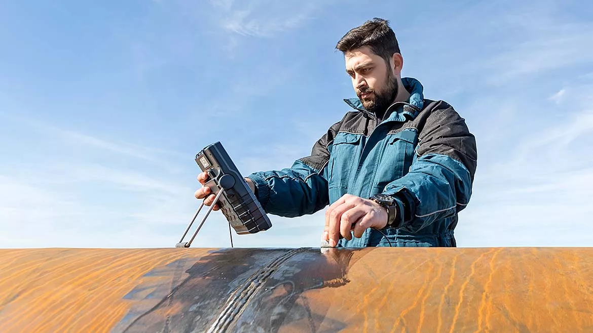

The image shows a technician performing ultrasonic testing (UT), a non-destructive testing (NDT) method
Image credit: Funtay/iStock, royalty-free.

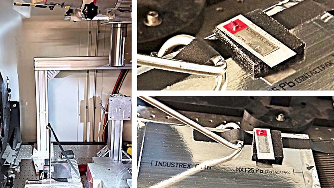

Typical small diameter tubing radiography testing set up
Source: Eddie Pompa and Ajay Koshti
Radiography testing often requires similar creativity to acquire the appropriate number of radiographs to comply with code requirements. As seen in the image below the use of tape to hold a small stainless steel tubing weld in the precarious position needed to complete the inspection.

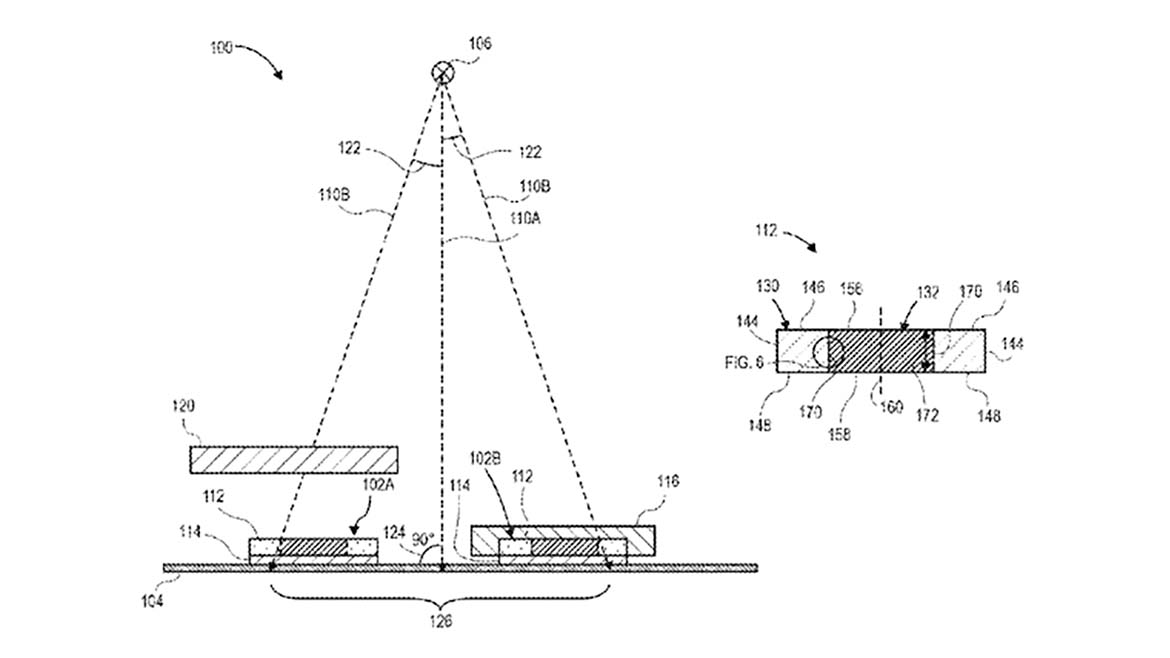

Radiographic Crack
Radiographic Crack Image Quality Indicator – US Patent No.: US 11,747,287 B1

United States Patent, Koshti, Patent No.: US 11,747,287 B1 – Radiographic Crack Image Quality Indicator System and Method
