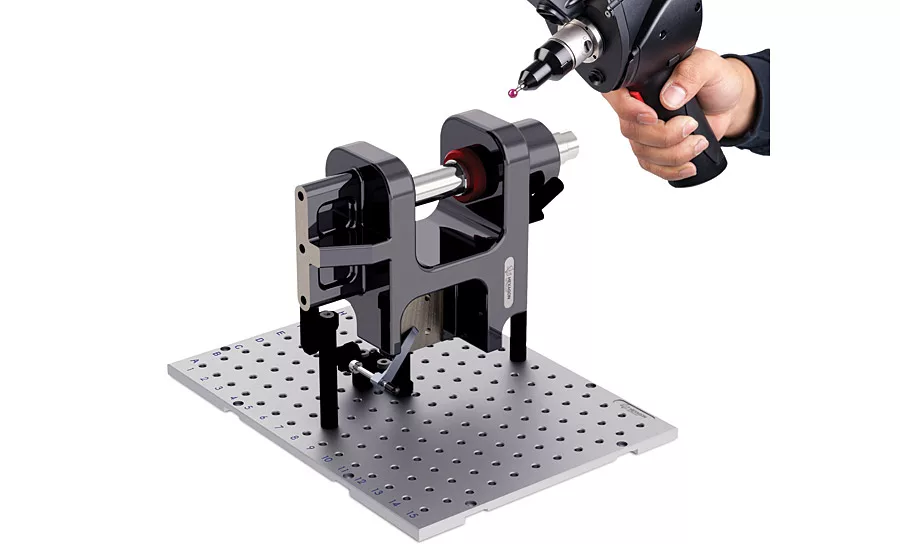

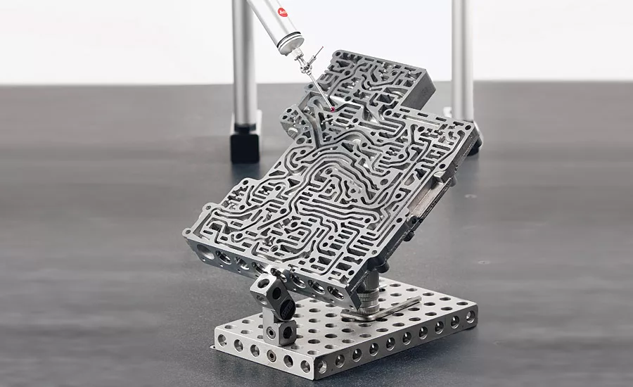

Many manufactured components today are complex, which makes it difficult to probe and access features for measurement. Swift-fix fixturing systems allow fixtures of varying sizes and complexity to be constructed, then taken apart and reused for other projects. Source: Hexagon Manufacturing Intelligence

In addition to CMMs, Swift-fix modular fixturing systems are also designed to work with a wide range of measurement equipment including portable articulating arms, laser scanners, and optical and multi-sensor vision machines. Source: Hexagon Manufacturing Intelligence

To address all of the requirements of a measuring solution, fixture systems have evolved over the years. These kits now offer the user a choice of base plates, standoffs, risers, clamps and more that can be used in combination to build a fixture suitable for a particular job. Flexibility is the key element here. 3D CAD models of many fixture system components are now integrated in the offline environment of the most widely used CMM programming packages available today. Many manufacturers take advantage of the modular nature of these systems to save money and improve their overall results. They train their CMM operators how to assemble various components for a particular job, disassemble them and reassemble then in another fashion for the next job.
