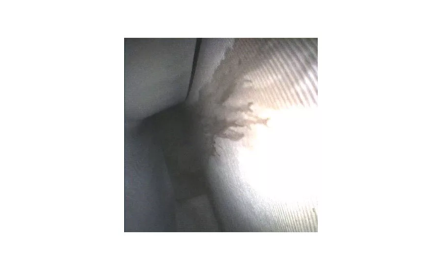

Light washout – Point the camera and LEDs away from the sidewall and down.

6. Once you have oriented yourself inside the component and have identified your inspection target, you can make adjustments to the LEDs and Gain control as necessary to avoid bright-light washout and glare. While making these “fine tune” adjustments, very slowly move the insertion tube just a few centimeters in and out while moving the joystick articulation controller a few degrees at a time. This will help you determine the optimal camera distance and viewing angle that will provide the best image of your target area.
