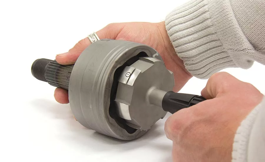

The vast majority of air tooling measurements fall within the range of .111” to 8”. But that is not to say that small or larger applications cannot be solved with an air gage. Source: Mahr

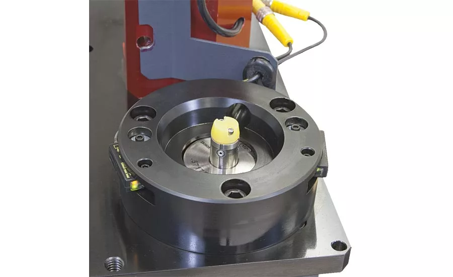

As air is compressible and system pressure must stabilize prior to measurement, one way to speed the process is to never have the air tooling flow to open atmosphere.
As air is compressible and system pressure must stabilize prior to measurement, one way to speed the process is to never have the air tooling flow to open atmosphere. This involves using a master or part replica for when the gage is not actually measuring a part. For example, the air plug could be in the master when at rest, and when the part is placed on the master, the plug moves into the part without any drastic air pressure change. Source: Mahr

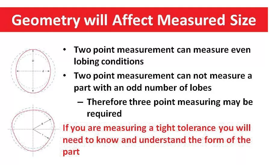

Understanding the geometry of the part is key in any dimensional check.
Understanding the geometry of the part is key in any dimensional check. But because of the ability of air gaging to measure some very tight tolerances, the form error can take up a significant portion of the dimensional tolerance. Source: Mahr

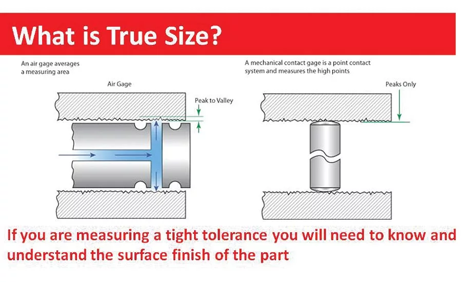

Air jets do not measure a ‘point’ really, but the average area of the surface the jet is covering.
Air jets do not measure a ‘point’ really, but the average area of the surface the jet is covering. When finish, or roughness, of that surface is considered, the measurement point of the air jet is actually the average of the peaks and valleys the jet is exposed to. Source: Mahr

Air gaging has many advantages as an inspection method. It is quick and easy to use, and requires little skill on the part of the operator. It is highly adaptable to measuring special features for both dimensional and geometric tolerances, ranging from simple IDs and ODs to taper, flatness, and runout. With different tooling readily installed on the gage display unit, it can be highly economical. And as a noncontact form of measurement (in the sense that there are no hard contacts), air gaging is useful for measuring delicate or flexible surfaces, and surfaces easily marred with normal contacts.
Air gaging is a great choice for part inspection, but since it is virtually custom made per application, it is critical to know the commandments for selecting and using air gaging before making that purchase decision. Followed properly these “Thou shalts and Thou shalt nots” will provide a highly successful inspection system.

5. Know the surface finish of the part
The response of air to surface finish is a little complicated. Air jets do not measure a ‘point’ really, but the average area of the surface the jet is covering. When finish, or roughness, of that surface is considered, the measurement point of the air jet is actually the average of the peaks and valleys the jet is exposed to. This is not the same measured point you would have if a contact type probe were used. This difference is a source of real gaging error, and one that is most often apparent when two different inspection processes are used.
As a general rule, the limit for surface finish with an air gage is about 60µ" Ra, but it really depends on the part tolerance.
This source of error should also be considered when setting the plug and comparator to pneumatic zero. For most applications, there should be no more than 50µ" Ra difference between the master and the part the gage is measuring. Even this can be significant if the tolerance of the part is as little as 0.001".
6. Know the form of the part
Generally speaking, out-of-roundness is either symmetrical, involving regular or geometrically arranged lobes or points on the part’s circumference, or asymmetrical, where lobing is not regular. Most machining processes create symmetrical lobing, producing either an even or an odd number of lobes.
Where an even number of lobes is arranged geometrically on the part, each lobe is opposed by one diametrically opposite. The piece, therefore, will have major and minor diameters. Knowing this, we can gage the part using a simple two-point air plug or ring. The difference in the measurements is easily read and can even be used to provide an indication of out-of-round conditions.
Parts with an odd number of lobes pose a slightly more complicated problem. In this case, each lobe is diametrically opposed by a flat area. These parts cannot be measured with a two-point air plug system since it will read the same value as the plug is rotated through the diameter. However, by using an air tool with three jets, when the tool is rotated in the part, it would pick up the max and min diameters, providing the needed results for out-of-round or for matching with other components.

Air gaging is based on the physics properties of air, and air is compressible. This means that once the air jet is restricted by the part, the air channels in the tooling and air hose have to fill up with air and stabilize to the backpressure created by the restriction. In applications with very long hoses this can be quite noticeable. For most bench top, manual gaging applications this delay can be easily tolerated. But for high speed automated gaging applications, even a part of a second delay may be too much and either slow the machine speed or potentially provide incomplete measurements.
There are two ways to help speed the air pressure drop recovery issue. Since most automated applications require an air-to-electronic signal conditioner, the first step is to move the convertor as close to the tooling as possible, thus reducing hose length. The second is to never have the air tooling flow to open atmosphere. This involves using a master or part replica for when the gage is not actually measuring a part. For example, the air plug could be in the master when at rest, and when the part is placed on the master, the plug moves into the part without any drastic air pressure change. This speeds measurement and also has the benefit of mastering prior to each part measurement.
