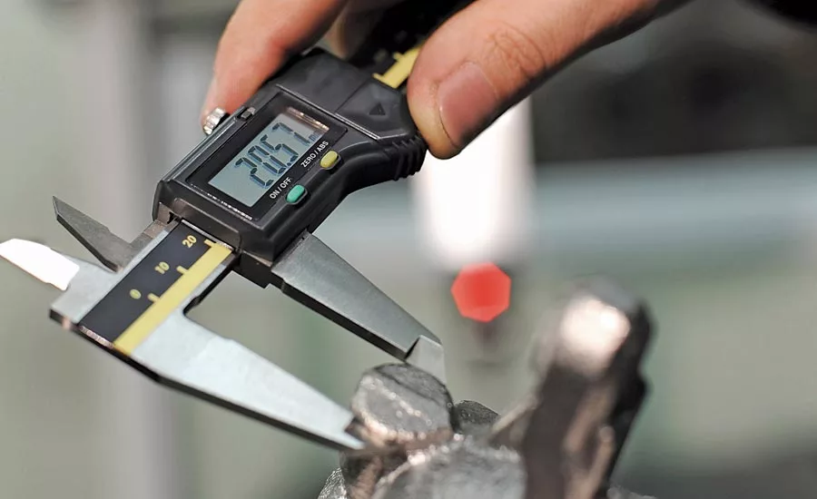

accuracty in measurement
Just ‘close enough’? For accuracy in measurement results, operational definitions are critical.
