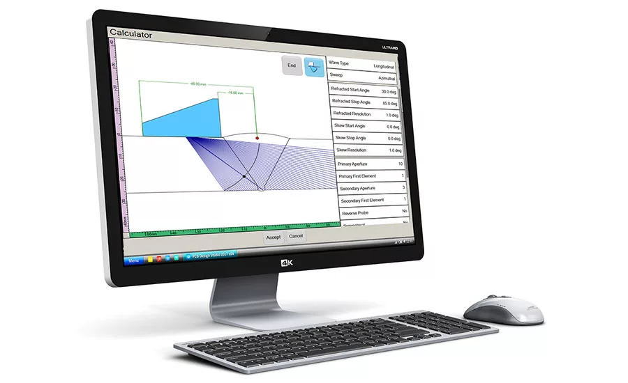

The latest portable phased array units with powerful embedded software allow inspections with 2D matrix array probes to be set up, deployed, and interpreted quickly and efficiently, eliminating the need to import focal law files created with an external calculator or to remote-control the system using advanced PC-based software.

Ideally, the weld should be inspected with four beam orientations (Figure 5), and two symmetrical wedge assemblies are required to examine from opposite directions, i.e. clockwise and counter clockwise. Depending on the frequency and the size of the individual elements of the array, wedge assemblies can be optimized to generate shear wave beams with refracted angles between 40° and 65°, and four or five skew angles between 25° and 50° relative to the scan axis direction. More than 50 acoustic beams are fired at each search unit position. The definition of focal law groups with different skews is easily handled by a sophisticated PA UT instrument with an on-board calculator, as shown in Figure 6.

Figure 6: Setting up inspection for axial cracks with weld cap in place.
