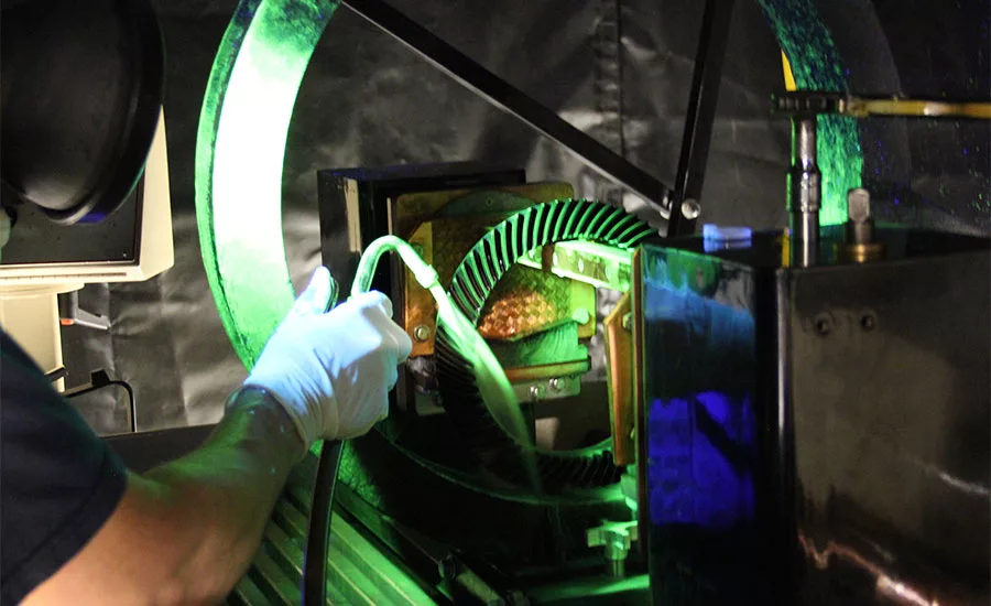

In the most general terms, MPI uses magnetism to help identify defects in ferromagnetic parts. The process can be completed by employing the basic physics of a magnetic field created by passing electric current through or over a conductor (or part to be inspected). The magnetic field induced in the part is then used to detect defects.
With the magnetic field in place, a test item is coated with a solution made up of fine magnetic particles coated with a brilliant fluorescent color, suspended in a light oil or water bath. In areas where the magnetic field is undisturbed, the particle bath will flow easily off of the part. In areas of disruption, there will be a small magnetic flux leakage field and particles will accumulate, creating a visual indication where the magnetic field is broken due to a discontinuity.
The defect can then be easily identified with the use of UV or ultraviolet inspection lamps, which cause the fluorescent particles to illuminate and stand out to the inspector. The whole process is performed in a darkened environment.
All parts that are subjected to MPI are tested in at least two different directions utilizing both circular and longitudinal fields. Once this multi-angle inspection is complete, the part is run through a demagnetizer to remove or reduce magnetism to within customer and industry specifications, and then cleaned with a degreaser followed by a light coating of oil for corrosion prevention.

MPI inspection
Parts are inspected at multiple angles—including the indirect contact method shown in this photo—to identify all potential cracks or other defects.
