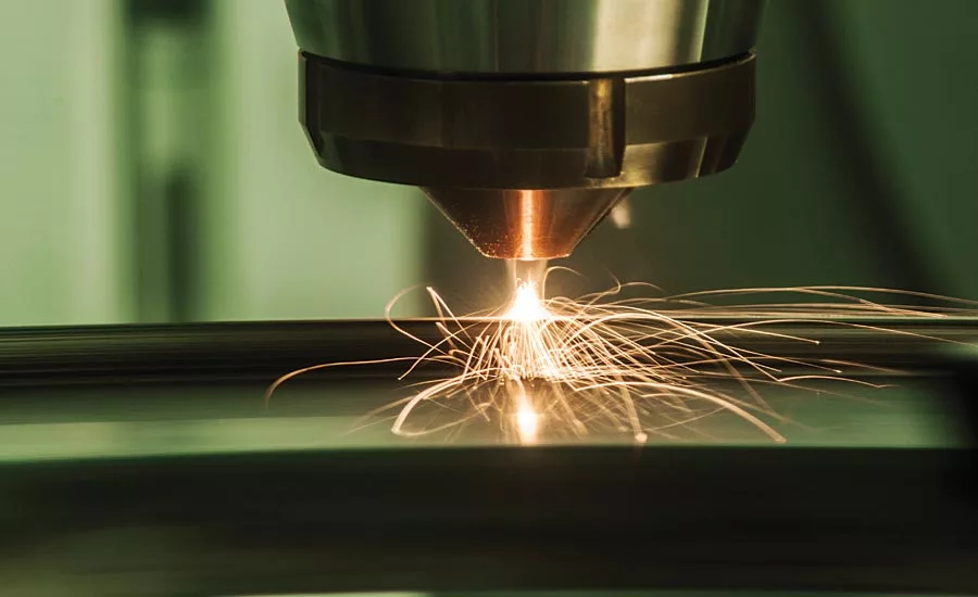

First off, AM is not just a single technology, but instead is a group of technologies. AM (commonly known as 3D printing) technologies are broken into two main groups: Powder Bed Fusion (PBF) and Direct Energy Deposition (DED).
Each of the two groups have multiple methods within them.

In DED, a powder or wire material is supplied to a melt pool in synchronization with an energy source which is again an electron beam or laser. Just as with PBF, the energy from the beam or laser will melt and fuse the material, but unlike PBF, the deposition spot is not fixed in X and Y. This means that either the surface being built and/or the energy source will be moving in relationship to the build design. DED is also different in that the building of the part layers can be in nearly any direction. This is a drastic difference between the two different AM approaches.
