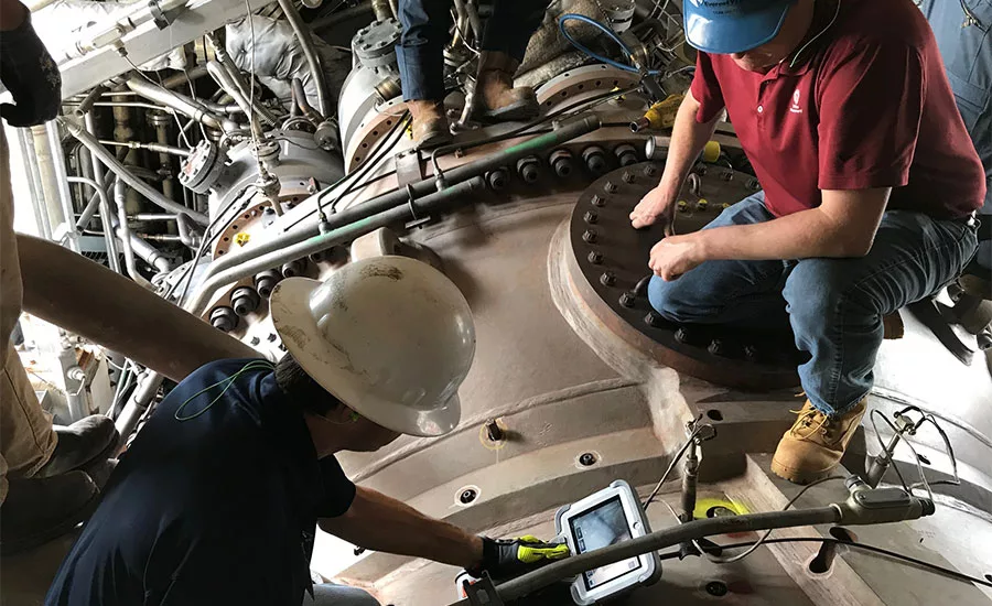

HD borescope of gas turbine
HD borescope of gas turbine.
