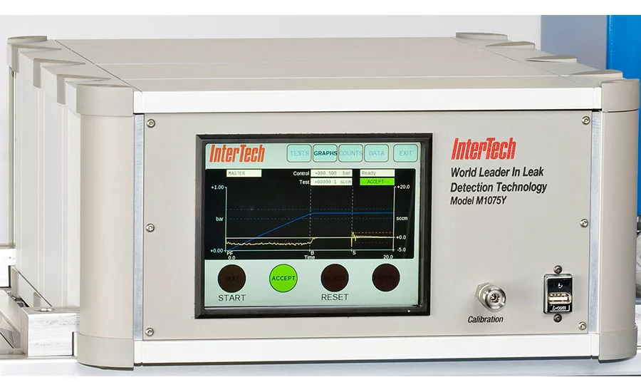

Many make the mistake of equating the upfront costs of a leak tester instrument with the costs of the leak testing in total. Over the economic life of a leak tester, the upfront costs of the test instrument are a mere fraction, often trivial, of the overall testing costs. The lower costs of pressure decay test instruments—where the change in pressure in a closed system due to a leak is quantified—are such that historically many manufacturers had, and still do, use this test method.
However, pressure-decay leak testing, though relatively cheap and easy has many disadvantages. Pressure decay measurements are highly vulnerable to changes in testing conditions, such as drafts or temperature. There are also often difficulties in determining the volume of test parts and test circuits, which must be known in order to calculate results. Also, pressure decay methods, including differential pressure decay methods, have hidden costs that derive from the need to make two measurements and then correlate results to determine a leak rate. Two measurements mean double the chances for measurement error. In addition, the longer the interval between the two measurements the higher the probability for measurement error—especially for leak testing large volume parts.
In contrast to pressure decay leak test methods, test instruments with mass flow sensors only require single direct measurements of leak rates. Unlike pressure decay sensors, mass flow test instruments aren’t encumbered with these built-in error sources and slower two-step test times inherent in pressure decay test methods.

Updated mass flow sensors that are tuned to the very precise testing conditions required achieve both shorter test cycles and higher accuracy. These updated sensors—unlike generic sensors—maintain high measurement accuracy across a wider range of air pressures and temperatures, ambient temperatures, and random, short-duration disturbances in measured airflow. Consider, for example, that the manufacturers of fuel regulators that must perform in both high temperature and high-pressure environments face a very different leak testing challenge than do manufacturers of sealed packages of sensitive electronics.

The more advanced manufacturing operations that have invested in robotics are finding that this can also impact leak testing. The variability that human operators can introduce in using a master part leak test for calibrations is usually captured in gage R&R standards. However, robots have a distinct advantage in that they can load masters in exactly the same way and at precisely correct times during automated setups. Robots also can initiate calibrations and verification cycles. This is the case whether sophisticated calibration instruments that can easily provide adjustable leak rates are used or less flexible systems that simply use masters with calibrated orifices.
