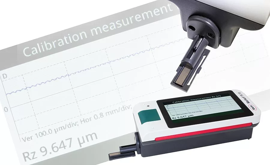

This calibration process is fairly simple. Just make a measurement of the surface reference specimen with the instrument using the Ra parameter and see what you get. Each reference specimen comes with a certificate of what the measured Ra value is. After the test, compare the results. It should be within the percentage of error as specified by your instrument manufacturer. If not, adjust the system using the manufacturer’s process and then re-measure the reference specimen. If the results still are not accurate, there may be an issue with the unit or the probe. This two-step process provides a double check: one of the system and one of the probe.
measurement accuracy
For measurement accuracy, the ideal situation is to have the skid on the measurement probe sit atop the peaks on the surface of the part. This will ensure that no mechanical filtering of the measurement results occurs.
Once there is a successful full range calibration, it is wise to verify the total performance of the system, especially the probe with a fine calibration patch. This is important for two reasons. First, it will verify that your instrument is producing the correct results after the calibration. Second, if the result is not right, it probably is not the calibration but rather that the diamond radius tip is starting to wear. This test is the other part of the physical inspection of the probe contact. As mentioned above, it provides a numerical value test of the probe contact. As the diamond wears or becomes chipped, it will either span (ride the peaks) or go further into the valleys and give improper results. Repeat the same process with a patch certified for a typical value of 16uin/3,2um. This final test shows that the system is within its calibration limits or, if not, may point to a worn stylus.
