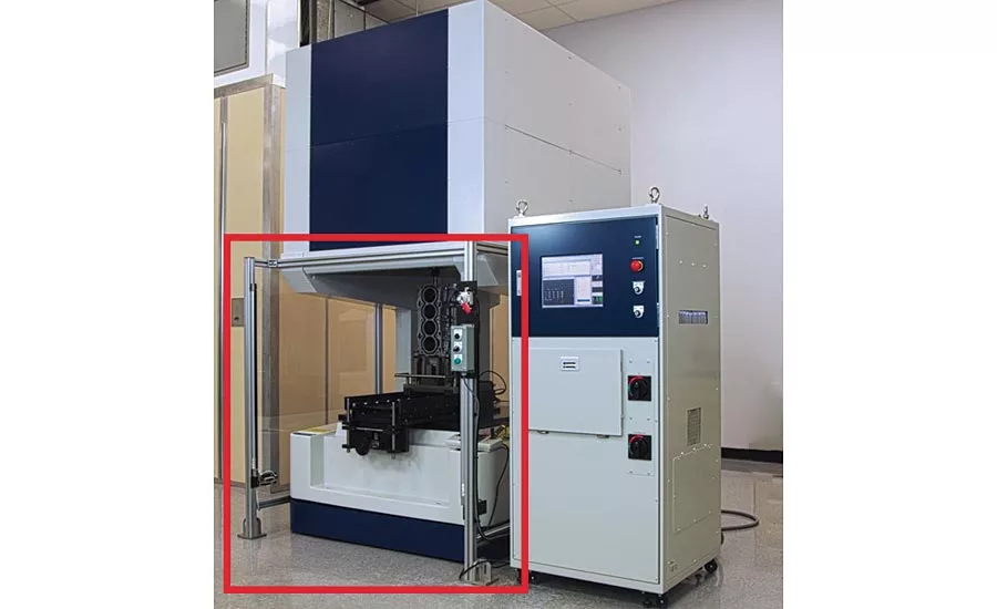

Pictured here is a CMM
Pictured here is a CMM with the light curtain highlighted. The light curtain shuts the machine down when the light beam is broken.

There are several ways to approach this and many of them are factors of the environment in which they must withstand and the training level of the planned operator. With a “shop floor rated” CMM, the approach might be a simple safety mat, light curtain or zone/area sensor tied to the internal safety circuits of the machine.

Many CMMs are now built with safety features incorporated directly into the machine design. For example, when a stylus is hit accidentally, the CMM will immediately stop automatically. There are other physical safety provisions available such as a light curtain safety switch or safety pressure mat, but the best form of safety is personal and situational awareness. Following simple safety rules like not standing near or leaning against a machine in standby mode will make the workspace safer at zero cost. Not placing items inside the machine volume or on the guideways where it can become a projectile when hit with force is another way to prevent serious injury from potential flying objects.
