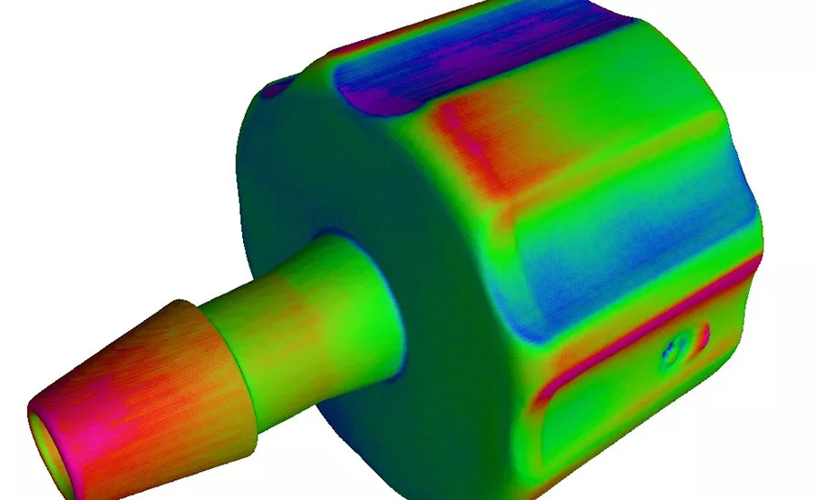

Importantly, CT scanning also improves product manufacturability. Plastic injection molders who use this nondestructive testing (NDT) technique can perform first article inspection, assembly analysis and reverse engineering activities. Applications for CT scanning also include part-to-CAD and part-to-part comparisons, showing a 3D color map highlighting any and all form deviations. By accelerating projects and allowing plastic injection molders to literally see inside parts, CT scanning supports the rapid identification of design issues and the efficient resolution of production discrepancies.

For example, 3D color maps can show an overlay of a plastic part atop the nominal 3D CAD file issued from the design team. For both plastic components and assembled devices, the scan can be rotated, zoomed, cropped, clipped, separated and explored in an intuitive 3D interface. Warmer colors indicate extra material, while colder colors signify missing material. This 3D analysis supports point-and-click manual measurements along with void/inclusion analysis so that users can see any unwanted form errors or voids inside the plastic.
