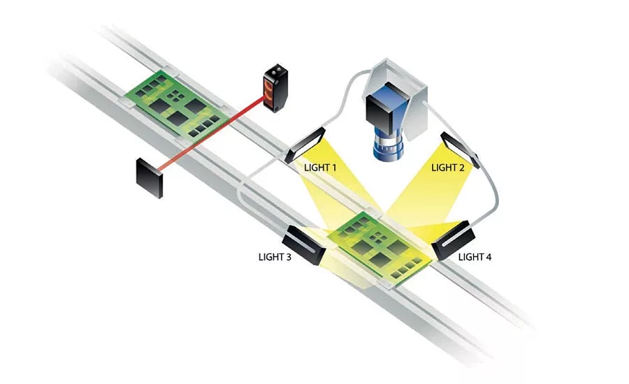

Multi-light imaging
Figure 1. Multi-light imaging of component using a single camera

It is possible to individually trigger multiple lights at different intensities and durations in a predefined sequence from one trigger signal. This is known as the pulse burst mode and allows different features to be highlighted in different images and multiple measurements to be made using a single camera station instead of needing multiple cameras. This can reduce the mechanical complexity and saves money by needing less equipment. The configuration is illustrated in Figure 1 and the timing diagram is shown in Figure 2. Multiple outputs are required from one trigger signal, so here a sensor on IP1 detects product presence. In this example, the four images need to be taken from the camera at 40ms intervals using four different lights. OP1, OP2, OP3, OP4 are used to output triggers to the lights and OP5 is used to trigger the camera. OP1 to OP4 are pulsed for 40ms in sequence. As each one is pulsed, OP5 is also pulsed for a short time to trigger the camera. The effects of this mode of operation can be seen in Figure 3 which shows images of the same component taken sequentially using a single camera with three different illumination sources. The image optimized for the barcode is produced using a ring light; the surface defect image is produced using dark field illumination and, finally, an on-axis, bright light is used for a dimensional check on the component.
