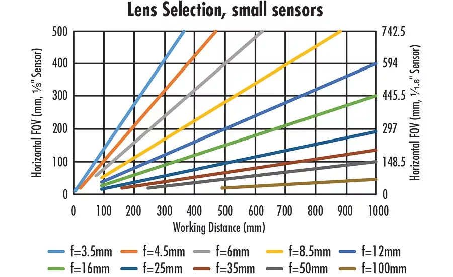

Figure 1: Lenses of different focal lengths and their fields of view on 1/3” and 1/1.8” sensors

Using the equation for magnification, Equation 2,
equation
where h’ and h are the size of the image plane (most often a sensor size) and field of view, respectively, Equation 1 can be rearranged into a much more useful form, shown in Equation 3.
equation
Equation 3 provides a quick and easy way to solve for which focal length lens is required to solve an application, given fundamental parameters such as field of view and sensor size. For the majority of applications the “-1” term can be dropped from Equation 3, as generally z⁄f»1.
Figures 1 and 2 show Equation 3 plotted for several lenses with different focal lengths, on different sensors (corresponding to separate y-axes).
These plots can be quite useful in determining the proper focal length for a machine vision lens if a camera has already been chosen: simply follow along the x-axis to the required working distance, and, using the corresponding y-axis (depending on the sensor that is being used), find where the points meet on the coordinate plane. The closest lens to the intersecting points describes the best starting point of investigation for which lens to use, and narrows the large field of lenses considerably.
Additionally, these plots also illustrate several important points about fixed focal length lenses in machine vision. First, longer focal length lenses have longer minimum working distances, which is a consequence of their optical designs. Minimum working distance can be shortened by adding spacers between the lens and camera, but image quality will eventually suffer. Second, larger sensors provide larger FOVs with the same focal length lens. For example, at a working distance of 350mm, a 12mm lens on a 2/3” sensor will have an FOV of about 370mm, but on a 1” sensor at the same working distance, the field of view is approximately 530mm—an increase of 43%. Lastly, there are gaps in the plots, indicative that a standard off-the-shelf fixed focal length lens does not exist. For example, it is impossible to achieve a 525mm field of view at a 600mm working distance with a 2/3” sensor with available focal lengths in this plot. The closest lens that exists is an 8.5mm focal length, which would need to be used at a working distance of about 510mm to achieve that field of view.
It is important to note that using these plots is only the first step in narrowing down which lens is the best for an application. They do not answer questions about image quality, distortion, relative illumination, or any other important qualities of an imaging lens; they merely approximate field of view relative to sensor size.
