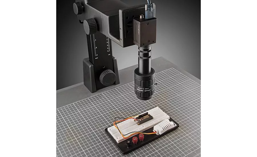

Macro lenses can be thought of as a subset of fixed focal length lenses, where the magnification is around 1X (the sensor is the same size as the object) or a bit greater, and the working distance is relatively small. Due to their high magnifications, macro lenses tend to run at an f/# that is generally around a factor of two larger than what is stated on their barrels. Often, typical fixed focal length lenses can be turned into macro lenses with the use of spacers or by reversing them such that they image backwards. See Figure 3 for a lens in macro configuration and the resulting image.
macro lens
Figure 3: Macro lens inspecting a printed circuit board (above) and the resulting image (below)
