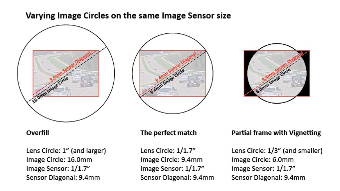

Matching the lens’ image circle to or exceeding the camera sensor diagonal is fundamental to capturing the full image. If the image circle is less than the sensor diagonal, portions of the sensor will not receive light, resulting in dark corners (vignetting) or unusable image regions (Fig 1).
In factory automation systems that rely on full-frame inspection, such as label verification or large assembly inspection, lost pixels reduce coverage and can lead to missed defects. Ensuring full sensor coverage is therefore essential to maintaining inspection accuracy and consistency.
Evixmatic 20
Fig 1. Lens image circle vs. sensor size: overfill (wasted coverage), matched (full coverage), and undersized (vignetting and lost image data).Source: Theia Technologies

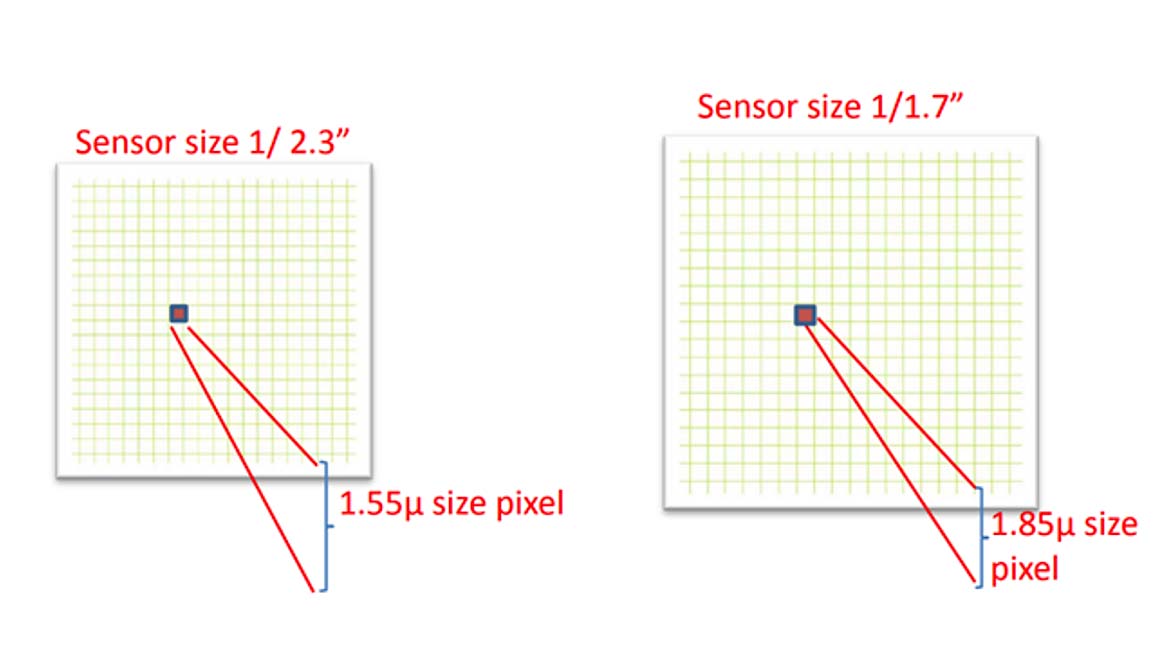

A sensor’s pixel structure, defined by the size and arrangement or density of individual pixels on the sensor, determines how much detail can be captured. Pixel pitch, or the distance between pixel centers, determines the smallest detail the sensor can detect. Smaller pixels allow finer detail capture but collect less light, reducing sensitivity. Larger pixels improve light collection at the cost of fine resolution (Fig 2)
Evixmatic 20
Fig 2. Two sensor examples: a smaller 1/2.3" sensor with finer pixels for higher detail, and a larger 1/1.7" sensor with bigger pixels for improved low-light performance. Source: Theia Technologies

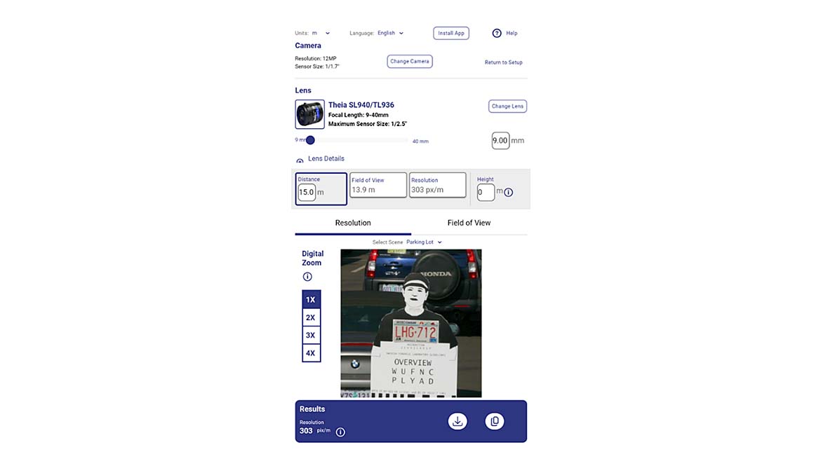

Tools like our Lens Calculator and Resolution Simulator help system designers evaluate trade-offs by estimating pixel density and field of view based on camera sensor size and resolution, lens parameters such as focal length, and system geometry including distance, height, and angle (Fig 3). This enables systems designers and engineers to quickly assess whether a given configuration meets the requirements of the application.
Evixmatic 20
Fig. 3 Lens Calculators such as Theia’s Lens Calculator and Resolution Simulator enable users to model and evaluate vision system performance by virtually testing lenses, sensors, and system parameters before implementation.Source: Theia Technologies
