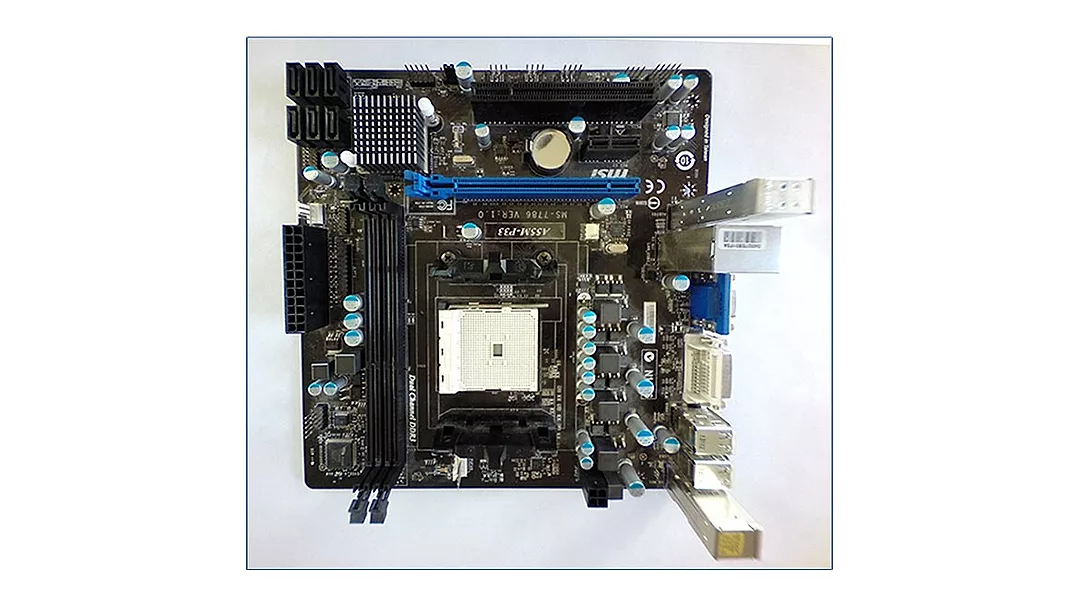

Circuit DIST
Image Source: Theia Technologies

Circuit DIST

Rectilinear lenses keep straight lines in the real world straight on the image sensor. One effect of this is an effect called lean-over (or keystoning) when two parallel lines seem to converge at the horizon. Since these two lines are imaged as straight lines on the sensor, they will appear to converge in a keystone shape as they move farther from the camera. This looks like the object is leaning away from the viewer. One exception, and where rectilinear lenses excel, is when the lines are in a different plane perpendicular to the optical axis such as imaging an LCD screen for defects. In this case, the straight lines of the LCD object will be imaged as straight lines on the image sensor. Each pixel of the image sensor will cover the same area of the LCD object and the image will appear rectilinear. If the same object were imaged by an equiangular fisheye lens, the edges of the LCD would be curved and compressed. An area of the LCD object at the image edge would cover far fewer image sensor pixels than the same size area at the center of the LCD, unlike the rectilinear case.
