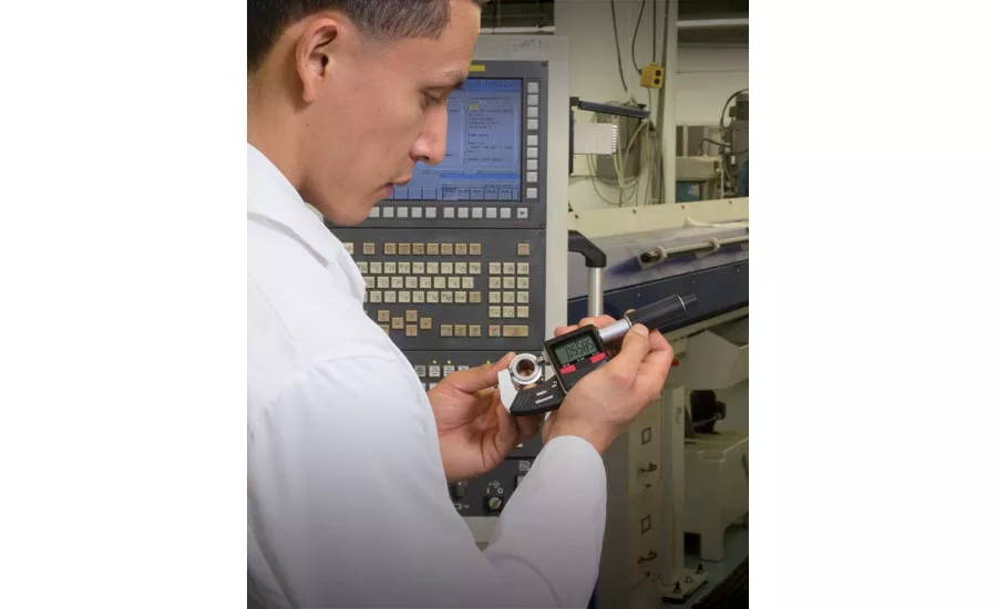

smart hand tools
Today’s smart hand tools provide information for machine control and inform the operator of part quality with tolerance indication.

To accomplish this, small transmitters are now being built into digital calipers, digital micrometers and digital indicators on gages that allow them to transmit data to a computer. Each integrated transmitter in the measuring tool uses a slightly different signal coding that allows as many gaging stations as possible to communicate to a single computer simultaneously. Today, these transmitters are not that much more expensive than data cables, making the cost more than justifiable when cabling alone won’t get the job done.
This technology is ideal for the in-process/right-at-the-machine-tool application. Transmitted wirelessly into the machine tool’s controller, the data can be put to use as part of the calculation for offsetting. Thus, as the operator measures the parts, the data is used to assign the proper offsets, greatly improving the quality and throughput of the machine tool. Out-of-spec parts are virtually eliminated, and the ability of the machine to make parts to the desired dimensions is greatly improved.
Now, with these transmitters, very large parts can be measured where they sit, or parts can be measured in the machine tool without having cables get caught in the tooling. Additionally, the tools provide visual feedback by generating a signal to the operator that the transmission was received and acknowledged by the computer. This is virtually instantaneous so as not to slow the operator down, and most transmitters can be configured to provide a go or no-go signal to the user depending on whether the part is within tolerance.
At the same time, the data can be stored for long-term archiving in the cloud, recording when the part was measured and by whom. It can also be used for tracking and improving operator throughput.
