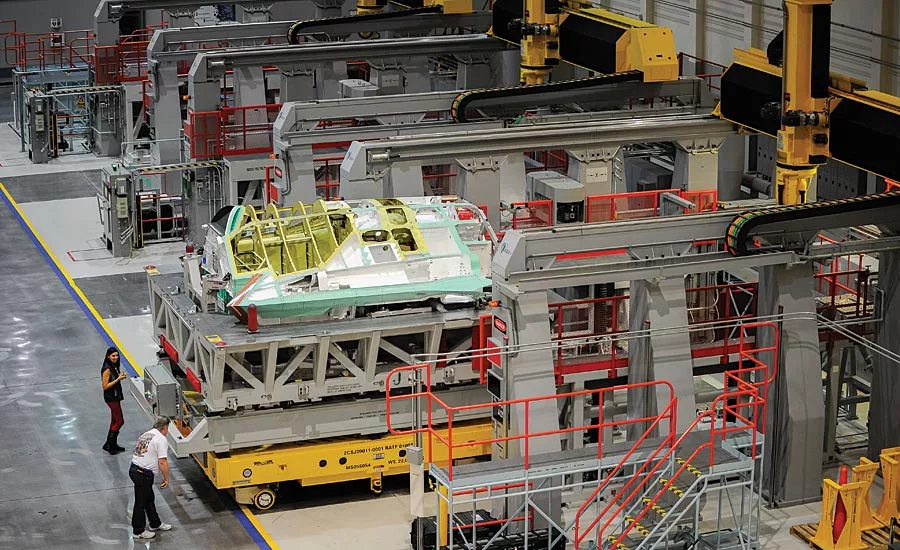

Northrop Grumman builds the center fuselage of the F-35, the section behind the cockpit, which is 18% of the vehicle content. This center fuselage section calls for several variations, such as the Air Force variant. The fast moving line is agile enough to handle change, and accurate to very tight tolerances.
Not only does the company produce sections for highly sophisticated aircraft, they have automated much of the process as well. The robotic drilling system works with a vision system to drill about 300 to 400 holes in each inlet. Previously, a technician would be inside the duct, which made it difficult to maintain the rate of production, not to mention lugging a tool inside a sensitive piece of equipment. Instead of the manual process to inspect every hole, now machines inspect and collect data.
“Automation set us free,” Andree says. “Now we can focus, instead of detailed inspection, we can look at data and data trends. Before we might have had 15 different data points from multiple systems. Now we can collect that data and act on it.”
“It would be very difficult to go back,” Carruth says.
The fuselage is built from the inside out. As we walked the production line, the tooling moves along with the airplane into each section. This means less opportunities for problems to crop up.
At the end of the long aisle, two major sections come together with very tight tolerances. The units match, despite the vast distance in the supply chain.
