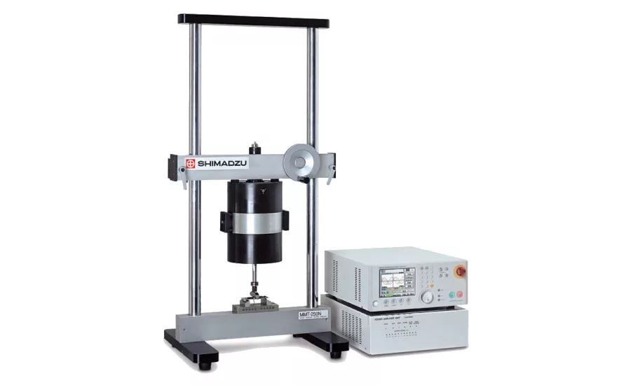

Electromagnetic Force Micro Material Testing Machine

Universal testing instruments offer a range of test options for electronics, including peel tests, shear tests, and cyclic bending tests. For example, the test jig could measuring the peel strength of the pins of IC chips; press vertically on the components to measure the shear strength; and observe fluctuations in resistance in response to cyclic loads in printed circuit boards. This allows for reproducing tests where thermal expansion and contraction of solder are repeated.
According to Shimadzu, “Heat generated internally in components during equipment operation and repeated ambient temperature fluctuations can apply stresses to the solder joints between the PCB lands and the surface-mounted component terminals, significantly affecting reliability. Therefore, it is important to evaluate the strength of the soldered joints, and one method of doing this is to test their peeling strength.”
