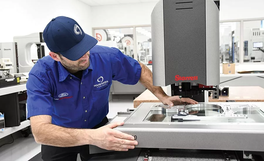

Joshua Whelan, Roush Yates Manufacturing Solutions quality manager, inspects a motor plate on the Starrett AV450 Multi-Sensor Vision System. Photos courtesy of Roush Yates Engines

One of the metrology systems that RYE chose for quality control is the Starrett AV450 Automatic Vision System featuring Metlogix M3 software. The AV450 is a multi-sensor (optics, video, laser and touch probe capable) system with a large X,Y,Z measuring /working volume of 18” x 14” x 8” (450mm x 350mm x 200mm). System accuracy is in the several micron range depending on the size of the part being measured. The AV450 system can be used to manually measure a single feature on one part or to automatically measure multiple features on many parts in a program. A combination of probing methods may be combined in a single measurement sequence. The M3 software is intuitive and has unique features and touchscreen functionality that even enable minimally trained personnel to effectively utilize the system.

RYE has increased inspection throughput two-fold since using the Starrett AV450. “On top of the time savings, the AV450 is easy-to-use, so in addition to our quality lab personnel, machinists come into the lab to verify their parts,” says Whelan. “We are all able to measure faster with a much greater level of confidence and the system allows us to make adjustments if needed.”
Since the AV450 system offers automated system measurement routines, inspection speed and throughput can be dramatically increased. Repetitive parts data is cached, and the program can automatically call-up the stored data when the same part needs inspection again.
For example, it took an hour to inspect a motor plate with the old optical comparator. Now on the AV450 it takes 10 minutes. Whelan says, “We especially like the efficiency of the Renishaw touch probe. The touch probe allows us to measure 3D characteristics related to flat patterns. When you can measure multiple characteristics without changing your setup, inspection time savings is significant.”
