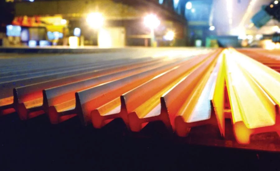

Tata Steel is the second largest steel manufacturer in Europe.  © Tata Steel Europe
