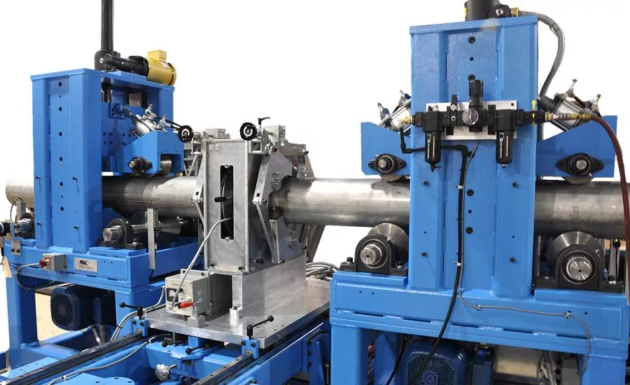

eddy current test system
This eddy current test system with encircling coil detects drilled through hole standards to meet ASTM 999 specifications in 60 mm to 219 mm, diameter tube.

65mm coil platform
This 65mm coil platform is used with encircling or sector eddy current test coils. Triple guide roll mechanisms ensures accurate positioning of the test product as it enters and leaves the test head.
