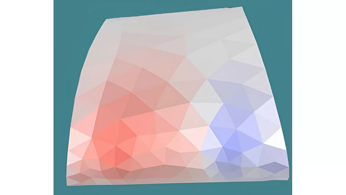

Meshing the surface into quasi-equilateral triangles. All Images Source: TD NDE

Optimizing machine utilization is critical in today’s manufacturing. Setting up the scan plan off-line using the 3D part surface drawing is the best way of reducing non-productive machine time. To implement such a mathematical simulation, the inspection parts are decomposed by meshing the surface. As all computations are based on the mesh quality, it is important that they be formed of quasi-equilateral triangles.
Inspection analysis remains easier in 2D space and, furthermore, all ultrasonic software packages are tailored to a 2D environment. As a robotic system works in 3D space, a streamlined conversion of 3D to 2D data is pivotal. The solution is based on a method, common in 3D animations, where conformal map projections are used to preserve local mesh angles and minimize distortion. Even though the overall shape changed, all grid lines still intersect at 90°. The 2D flattening preserves overall shapes to keep the flattened surface recognizable by the inspector. Not only does it make easier to validate the scanning path, but it also facilitates locating indications and decision-making when the final ultrasonic data is finally represented on a C scan. This representation, which is common in ultrasonic testing, is defined by the specification BS-EN 1330-4:2000 as the image of the results of an ultrasonic examination showing a cross section of the test object parallel to the surface. The flattening file is then saved as a textured OBJ file where each vortex has both 3D and 2D coordinates.
