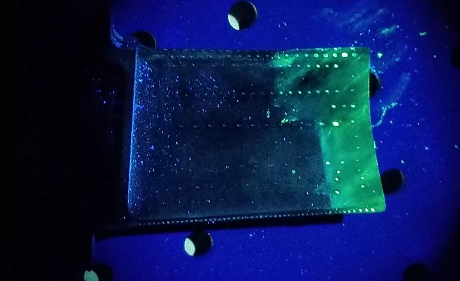

QTY July 2021 NDT in Aerospace 2 FPI Inspection. Source: Weaver NDT
Source: Weaver NDT
FPI Inspection of High Pressure Turbine Blade. Source: Weaver NDT

Penetrant testing, known as PT, also often called fluorescent penetrant inspection (FPI) is a liquid penetrant inspection. This is a very common NDT for surface applications in aerospace. For this method, components are coated with a liquid dye by dipping, spraying, or brushing. The parts are then subjected to a dwell time where the liquid penetrates defects using capillary action. After the dwell time has expired, the excess penetrant is removed from the surface leaving only the dye that has penetrated the defect remaining. A developer is then applied to pull any entrapped penetrant back to the surface and after another set period, the parts can be examined under ultraviolet light. Any visible dye indications are inspected and evaluated for disposition. The last step of the process is a thorough post-inspection cleaning. There are several different cleaning methods, but the key is to remove all the residual dye. PT is a very effective method, and it is used by nearly every aerospace company or by their suppliers.
