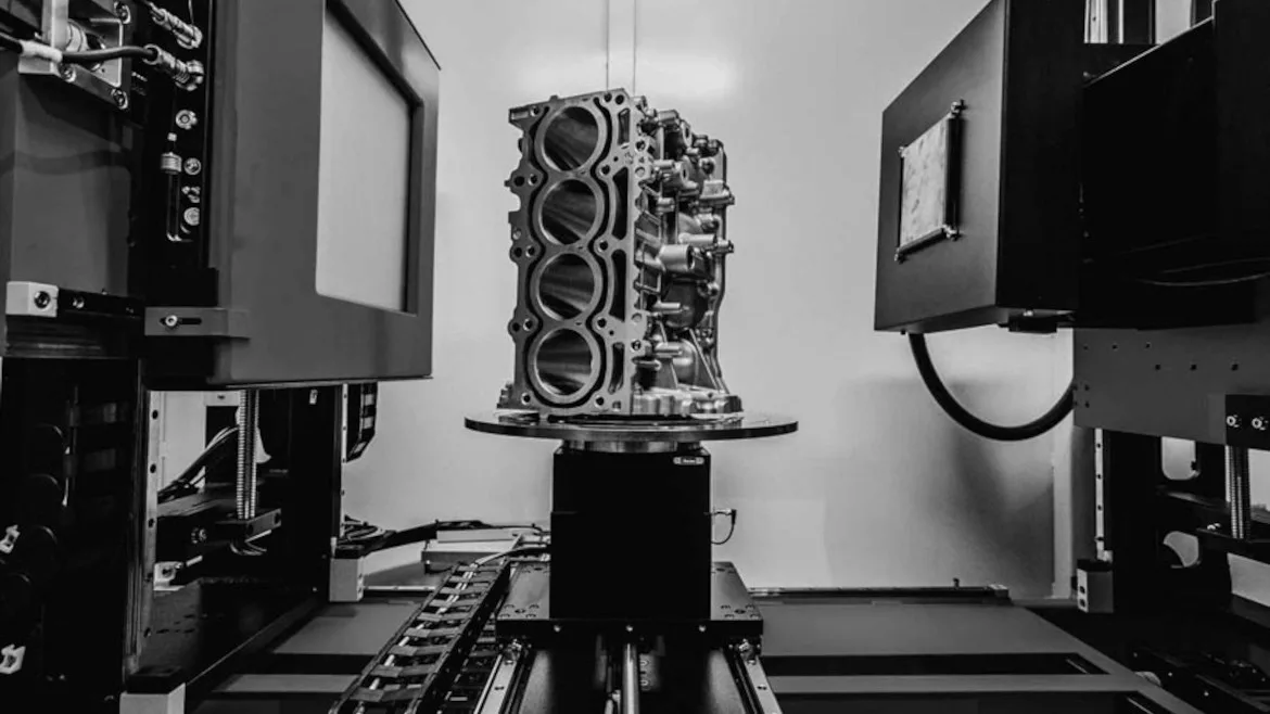

QM 1022 NDT Radiography 450 Engine Block
Scanning an engine block. Source: Haven Metrology
