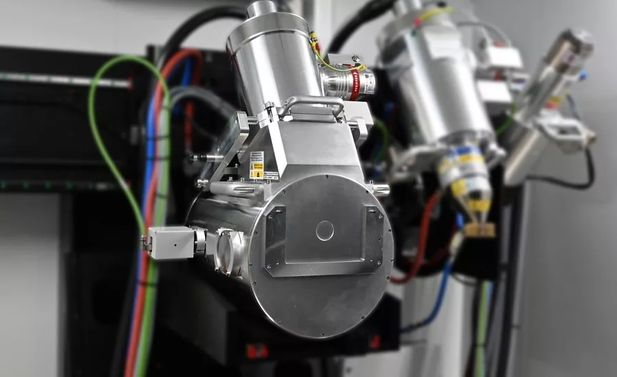

microfocus rotating target
Avonix/Nikon M2 X-ray System with Triple X-ray. Source: Avonix Imaging

With CT, the x-rays are still passing through the object with various levels of absorption and being collected at the detector, but there is also rotation and sometimes precise vertical movement being performed. For Medical CT and a few other special industrial applications, the x-ray source and detector are rotated around the subject. In most Industrial CT and NDT work, the object is rotated while the x-ray source and detector are static. There are also several different configurations and approaches for the hardware and data collection.  On the x-ray side, there is either mini focus and micro focus sources and on the detector side, there are larger area detectors and linear diode arrays (LDAs). The large area detectors are basically the same type of detectors used in digital x-ray and they capture the full scan in a volumetric manner. The LDAs are quite different. The LDA is a narrow band detector that captures one “slice” of the x-rays at a given Z height.
