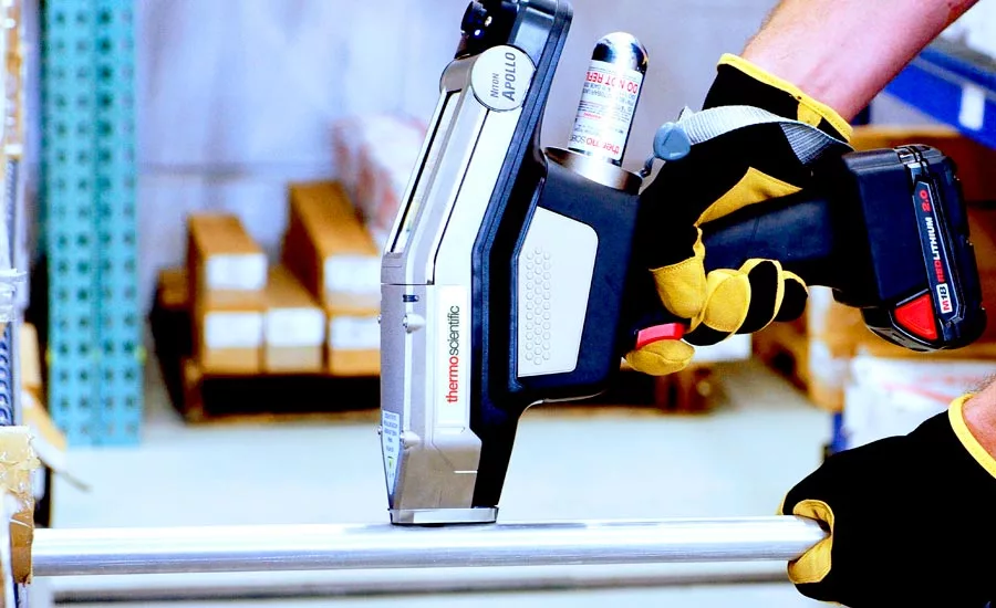

analytical technique
LIBS has been a longstanding analytical technique used for material verification.

Using LIBS Technology to Detect Carbon
LIBS has been a longstanding analytical technique used for material verification. It is only recently that companies have been able to crack the code on using the technology to measure carbon. Today, some handheld LIBS analyzers can quantify carbon concentrations in low alloy and L+H grade stainless steels, in addition to calculating carbon equivalency. Unlocking the ability to measure carbon will prove to be useful for quality control departments, metal fabricators, petrochemical plants, and scrap recyclers seeking to measure low concentrations of carbon in metal quickly, directly on the line, and under conditions where prior technologies were too cumbersome.
