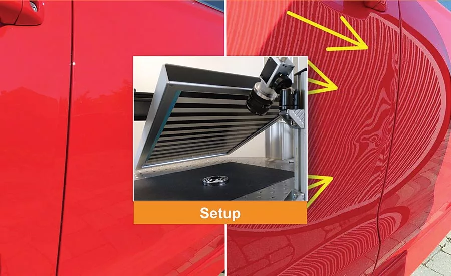

Deflectometry allows scratches on a vehicle body to be reliably detected. Source: MVTec Software GmbH

So how does this process work? An image acquisition unit, such as a USB3 Vision- or GenICam-compatible industrial camera, records digital image data from the reflective object to be inspected. A monitor is positioned diagonally across from the camera and simultaneously displays a sequence of striped patterns, which are reflected onto the surface and are visible in the recorded images. Based on the light reflections, the machine vision software calculates precisely where uneven areas are located on the object surface. As a result, even the tiniest defects that are invisible to the naked eye, such as scratches, bumps, cracks, dents, and air inclusions, can be accurately detected and located.
