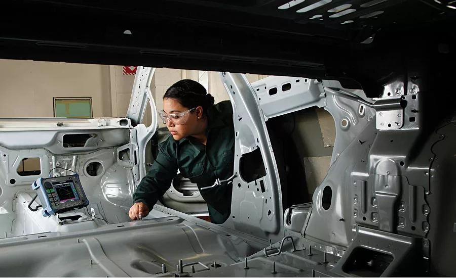

Worker assesses vehicle on the plant floor. Source: Olympus
