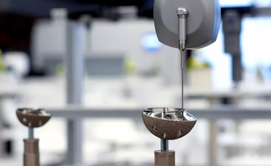

Acetabular Shell

ZEISS can fulfill all these needs with a range of non-contact inspection methods — from coordinate measuring machines (CMMs) to X-ray and industrial computed tomography (CT) to microscopy. “White light technology along with blue light lasers for CMMs are also some recent options,” says Newman. In addition, new sensors and systems are on the way.
ZEISS CMMs are critical for qualifying medical components, such as those used in robotic and prosthetic functions, as well as testing the functionality of medical devices. They strengthen a manufacturer’s quality inspection process and ensure that parts meet precise requirements and specifications, both for customers and regulators.
The orthopedic market — including knees, hips, shoulders, bones plates and screws — is a major focus for ZEISS, benefiting not just from CMMs but also CT. “CT is definitely a trend in medical inspection,” says Newman. “It’s growing more popular as more of the applications come forward. It’s a great tool for the geometry of a component, also porosity and detecting flaws within the component itself, even things like insulin pens and delivery systems with springs or a trigger component.”
