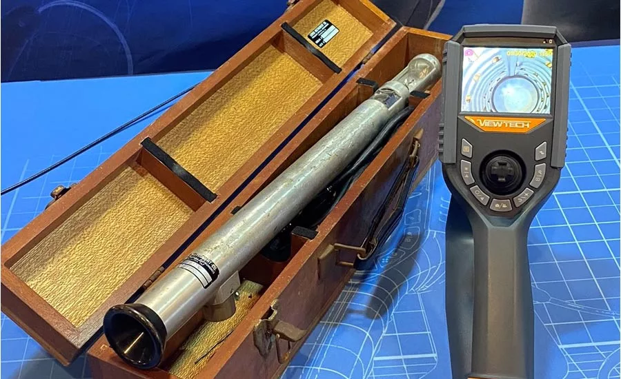

borescopes
The rigid tube borescope of 100 years ago has evolved into a device that would be unrecognizable to early borescope users.

Borescopes have been used to visually inspect internal componentry for over 100 years. During most of that time, the instrument consisted of a narrow, rigid tube with integrated lens, mirror(s), eyepiece and light source. Over the past few decades, however, breakthroughs in materials, electronics and manufacturing techniques have led to a series of innovations that have greatly expanded the capabilities of borescopes and, in turn, broadened their use in industry.
The first major breakthrough in borescope design was the development of fiber optic bundles, which allowed borescope insertion tubes to become flexible. This flexibility permitted visual access through curved channels and pathways. Soon afterwards, manufacturers began attaching video cameras to the proximal end of the “fiberscope,” allowing the user an easier way to view the remote image and enabling the capture of photos and video. Eventually, image sensors, LEDs and lens designs became small enough that they could be mounted directly onto the distal end of a flexible insertion tube, and the modern “video borescope” was born.
Manufacturers have been building off of this “distally-mounted camera/LED module” design for the past 15 to 20 years, relying on advancements in PCBs and image processors, as well as ever-smaller and more powerful image sensors. The end result is that the rigid tube borescope of 100 years ago has evolved into a device that would be unrecognizable to early borescope users.
