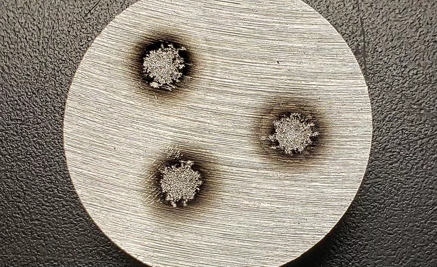

Spark OES
The source of excitation in Spark OES is an electrical discharge, or spark, between an electrode and a solid, metallic sample from which radiant energy is produced. The resulting light of select wavelengths is then converted into electrical energy which is then stored on capacitors. After a predetermined amount of energy is stored on the capacitor, or a fixed time has been reached, the spark ends. After the measurement is complete the instrument then calculates the charge on each capacitor and converts that information into a concentration.
To perform spark OES, a sample of appropriate size must first be prepared by finishing the surface of a sample with an abrasive grinder to provide a flat and even surface. Once the sample is prepared, a type standardization must be performed using a CRM. This is done by sparking the CRM a given number of times and producing concentration readings. The instrument then compares the measured value to the certified value and creates a factor that corrects the results to match the certified value of the CRM.
Spark OES boasts a quick analysis time allowing large numbers of samples to be tested over a short period. These instruments do not require a significant amount of maintenance to keep them in operating condition and have few reagents required to achieve a complete analysis, which results in a rather low cost of operation, as opposed to ICP-OES. With few moving parts, and a relatively simple design, spark analyzers can be a cost-effective approach to an analytical analysis.
Spark OES instrument
In addition, the instrument uses material from the surface of a specimen, meaning chemical compositions at exact depths can be tested to identify carbon levels in samples that have been heat treated, carburized, or decarburized. Spark OES is also useful for the surface testing of welds and to test sample homogeneity. Using this method can visually confirm that the base metal was not tested and gives the composition of weld wire after it has been welded to check for any weld dilution that could compromise the weld integrity. Similarly, spark OES analyzers can be used to test how homogenous a material is which is useful for suppliers. Homogeneity testing is necessary in the verification of CRMs. Testing multiple areas of the same sample shows the composition at specific locations revealing if a sample is homogenous or not.
Limitations to this method of analysis include a limitation of sample sizes, sample forms, and a lack of CRM flexibility. This method can only be performed on samples big enough to cover the aperture above where the electrode sits. This method also requires specimens to be a solid and flat, so the aperture is covered. Spark OES is unable to analyze sample types such as liquids, powders, springs, and other materials that cannot cover the aperture. Another limitation is a lack of CRM flexibility. The CRMs used for the type standardization typically come in solid rounds and have set concentrations. ICP OES has more flexibility with liquid CRMs that can even be used to make customized CRMs.
