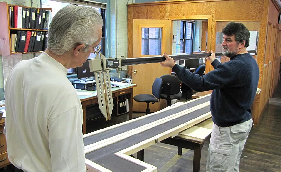

quality control lab
Carbon fiber calipers can be designed and manufactured up to 16 feet long and are light enough for two people.  Source for all photos: The L.S. Starrett Company

Enormous power generation turbines demand exceptionally large measuring gages. For easier handling while maintaining accuracy, special honeycomb micrometers that are light weight can be an excellent measuring solution.
Ultra-light honeycomb deep throat and large diameter gages feature the structural properties of honeycomb aluminum established according to standards covering the selection and use of this lightweight material. The results are long-range measurement to close tolerances in handheld gages of many configurations, all combining great rigidity with lightweight and ease of handling. These gages have been made up to 96” between contacts and are a fraction of the weight of other gages.
Carbon fiber calipers can be designed and manufactured up to 16 feet long and are light enough for two people. This made a job that originally required five people to hold a gage become a two person job.
