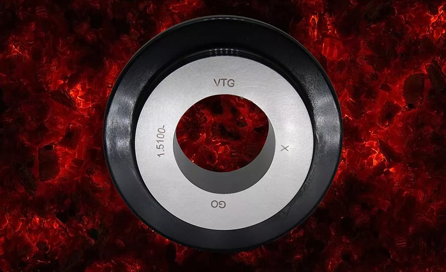

Cylindrical ring gages have a number of inspection purposes. They are used as Go/No-Go gages to inspect the outside diameter of a shaft or rod. They are masters for dial bore gages, internal micrometers and coordinate measuring machines (CMMs). They work well in applications where functional maximum material condition inspection of a shaft or other outside diameter is required.

The Go ring gage represents the maximum diameter of the outside diameter of a shaft or rod. The tolerance on the Go ring gage is applied, minus. The No-Go ring represents the minimum outside diameter. The gage tolerance is applied, plus. The No-Go ring gage has a groove ground into the outside diameter. This groove is used as a visual indicator that the ring is a No-Go cylindrical ring gage. The Go and Master rings do not have a groove on the OD. (Fig. 3)

Go cylindrical ring gages are functional inspection tools. They may be used to confirm maximum material condition (MMC) specifications of the outside diameter of shafts and rods. Using the Go ring in this manner complements the use of variable gages such as calipers and micrometers. The variable gages are good for measuring part-to-part deviations. The variable gage allows the user to make diameter adjustments while in the process of manufacturing the outside diameter of their part. The Go cylindrical ring represents the maximum material condition of the outside diameter of the part. If the part passes the two-point micrometer or caliper but does not pass the Go ring gage, the part fails at maximum material condition. This failure may indicate that the part is out of round. Two point measurements do not pick up geometrically odd sided or lobed parts. The Go ring gage represents the functional maximum diameter. The Go ring is required to have the roundness and taper within one-half of the total gage tolerance. A Go Class X cylindrical ring gage at 0.250” diameter will have a diameter tolerance of .250” -.000040”. The roundness for this gage is .000020” per ASME B89.1.6, table 2. If the part fits the Go ring gage, the outside diameter of the part is confirmed to be functionally smaller than the maximum material condition.
