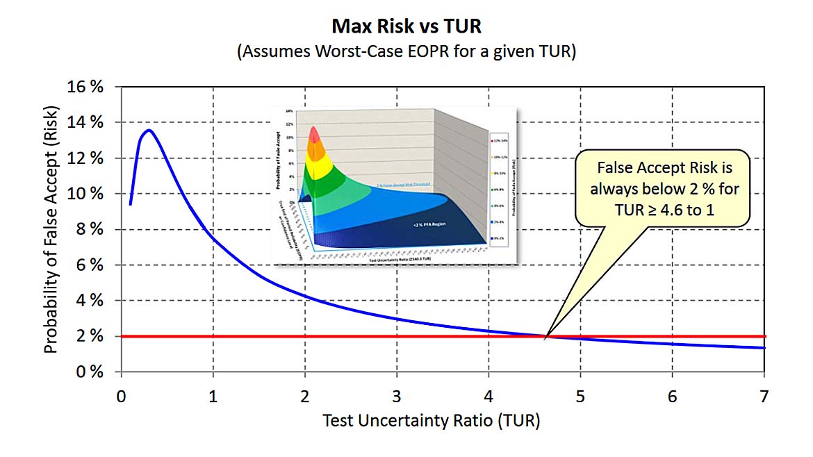

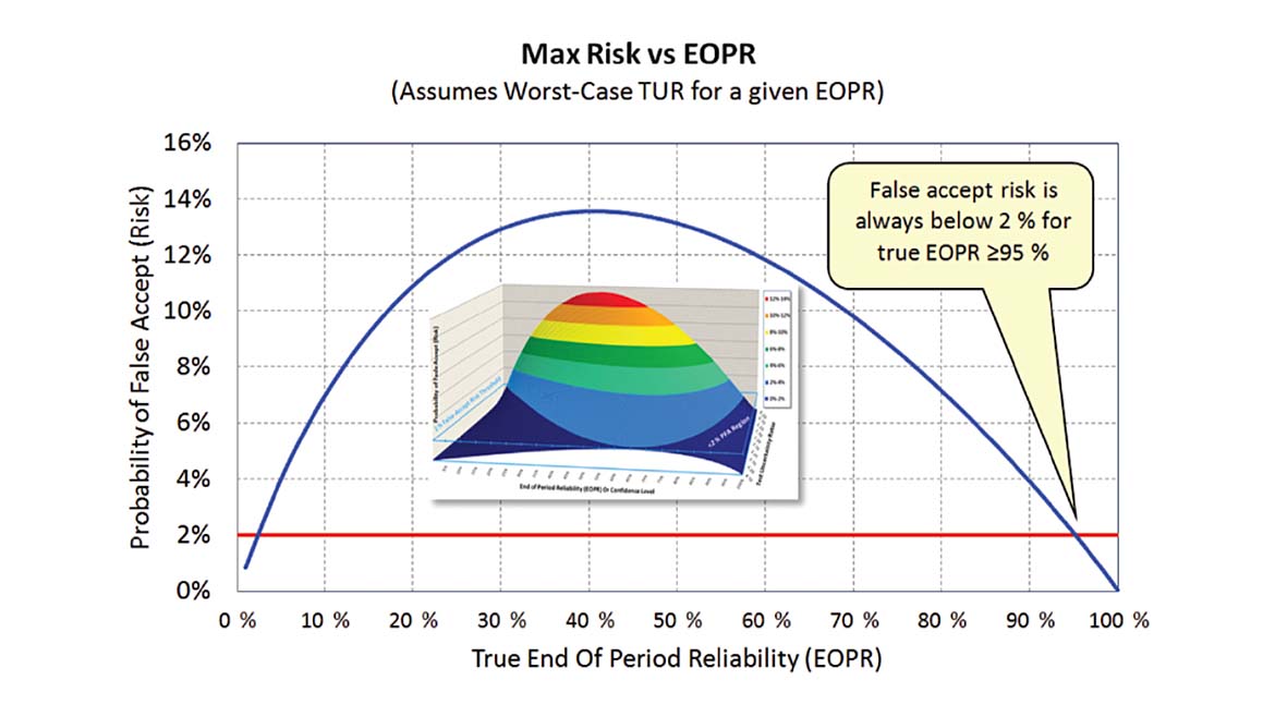

  • PFA (Probability of False Accept): The likelihood that an out-of-tolerance item is incorrectly accepted.
  • PFR (Probability of False Reject): The likelihood that an in-tolerance item is incorrectly rejected.
  • EOPR (End of Period Reliability): Historical probability that a measurement remains within tolerance at the end of a calibration cycle.

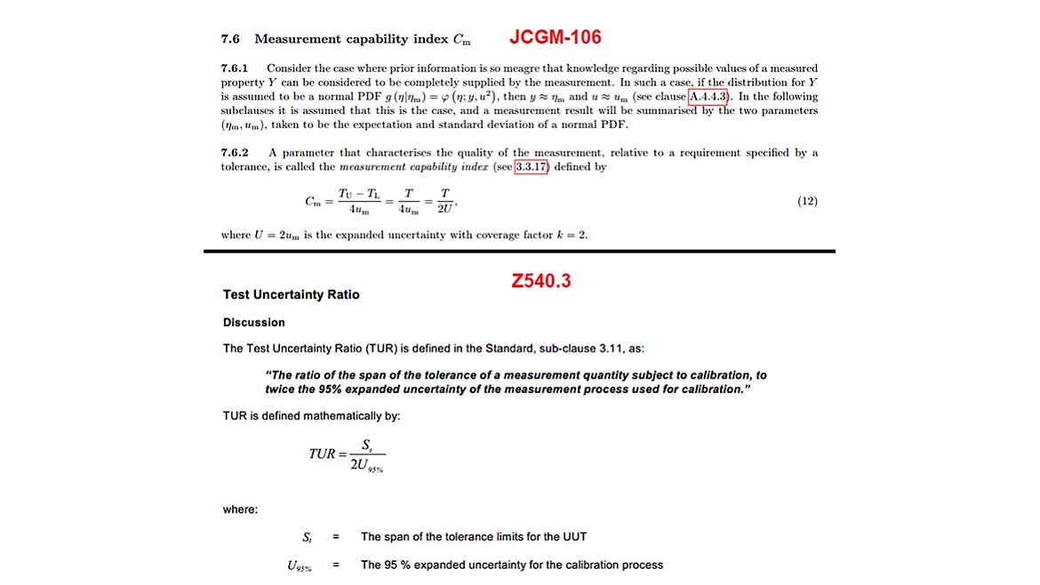

  • Decision Rule: is a rule that describes how measurement uncertainty is accounted for when stating conformity with a specified requirement. (ISO/IEC 17025:2017 3.7 "rule that describes how measurement uncertainty is accounted for when stating conformity with a specified requirement.")
  • TUR - the ratio of the tolerance, TL, of a measurement quantity, divided by the 95% expanded measurement uncertainty of the measurement process, where TUR = TL/U.
Note that this definition differs slightly from the one cited in ANSI/NCSLI Z540.3: 2006). The term Cm Measurement Capability Index is virtually identical to this definition of TUR (Appendix A example).
It is crucial to clearly understand these foundational terms, especially Specific Risk (point-based) versus Global Risk (system-based). Misinterpretation can result in incorrect conformity assessments and unnecessary operational costs.

  • Global risk is less sensitive to a single measurement and more concerned with aggregate reliability.
  • Often derived using historical reliability metrics like End-of-Period Reliability (EOPR) and Test Uncertainty Ratio (TUR).
  • It may use guard band multipliers designed to ensure that the maximum false accept risk across all tests remains below a target, such as 2 %.
Used when: uniform guard bands are applied to many items or test points, or when simplifying risk management across multiple calibrations.

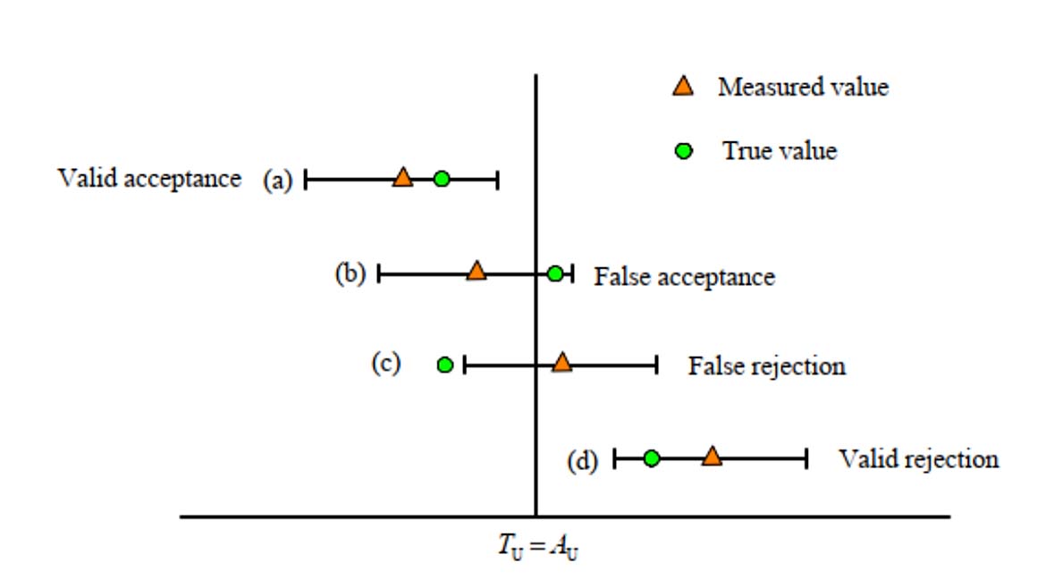

Though this language may not have been written explicitly to do so, it effectively precludes the use of vague or non-binary conformity statements. Terms like "Pass (Indeterminate)" or "Fail (Conditional)" introduce ambiguity into conformity decisions and fall outside the scope of ISO/IEC 17025–compliant reporting. The standard is clear: conformity must be stated in binary terms—Pass or Fail, Met or Not Met. If a laboratory chooses to use non-binary terms, it cannot, by definition, label the result a valid "statement of conformity."
Figure 1 JCGM 106 Valid Acceptance and Valid Rejection
Figure 1 JCGM 106 Valid Acceptance and Valid Rejection.
JCGM 106:2012 reinforces this position by emphasizing that conformity decisions are probabilistic and must be made using defined acceptance intervals. It warns that, "because of uncertainty in measurement, there is always the risk of incorrectly deciding whether or not an item conforms" [7, Clause 6.3.2.3]. Introducing non-binary language blurs that decision boundary and undermines the integrity of the decision rule applied. Worse, as JCGM 106 outlines in its treatment of acceptance and rejection zones, failure to clearly define the outcome increases the risk of false acceptances or rejections—precisely the risks conformity assessment systems aim to control.

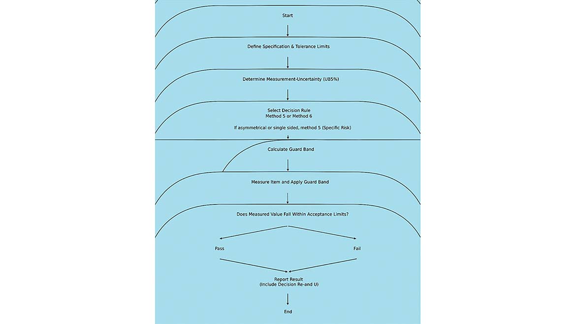

6. Overview of Method 5 (Specific Risk) and Method 6 (Global Risk)
Specific Risk refers to the probability that a particular measurement result falls within the acceptance zone while the true value is out of tolerance. This is commonly called the Probability of False Accept (PFA).
6.1 Method 5 (Specific Risk) Example: Two-Sided Guard Bands

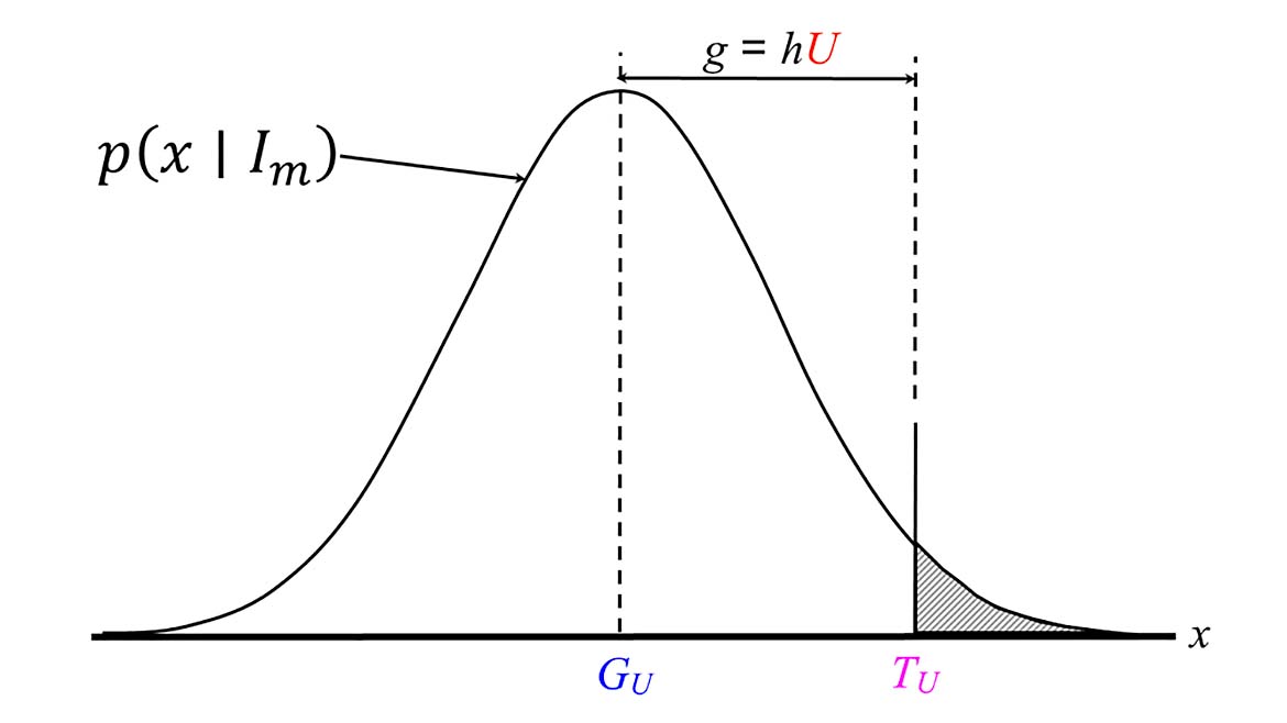

There are numerous methods for calculating acceptance limits. The method presented below applies to any level of risk. If the stakeholder says they want a 10% risk, it works; if they want a 1% risk, it works. Therefore, this is the de facto method for calculating specific risk.
ASME B89.7.4.1 2005 [6] provides an explicit method of setting the width of the acceptance zone for a specified probability of conformance.
The Guard band is a multiple of the expanded uncertainty of the measurement process, g=hU, where the Guard bands are the same size, gL = gU = g. The guard band multiplier (h) is given by:
h=1/2 ϕ^(-1) (P_C )
Formula to Calculate Specific Risk.
Where:
Φ-1  ( ) is the inverse standard normal distribution function—the Excel function to calculate  Φ-1 NORM.S.INV.
h is the guard band multiplier
U  is the Expanded Uncertainty
Pc is the probability of conformance
GU is TU – hU
TU is the Upper Tolerance Limit
Figure 2  Image Adopted from ASME B89.7.4.1- 2005 [6]
Figure 2  Image Adopted from ASME B89.7.4.1- 2005 [6].
The Guard Band is chosen so that a desired portion of the probability of conformance area under the curve lies inside the tolerance zone. ASME B89.7.4.1-2005 "Measurement Uncertainty and Conformance Testing: Risk Analysis," Section 8 [6].

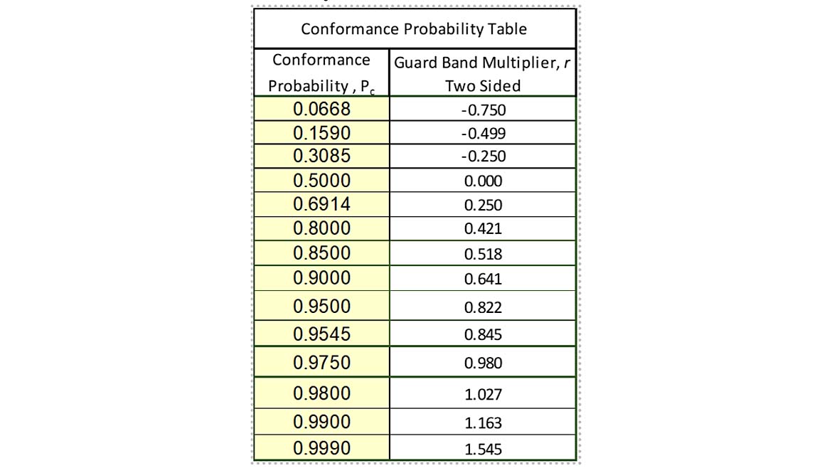

Example Specific Risk Acceptance Zone Calculations – Two-Sided
In this example from Decision Rule Guidance 1st Edition, V1.3, 2024 [8], we are trying to calculate the acceptance zone using a guard band to limit our risk to a 2.5 % limit between -1 (Lower Tolerance Limit) and + 1 (Upper Tolerance Limit) units with a standard measurement uncertainty of 0.125 units.
Figure 3 Conformance Probability Table
Figure 3 Conformance Probability Table. Source: Courtesy Morehouse Instrument Company
Our Standard Measurement Uncertainty (k = 1) is 0.125 units.
This Standard Measurement Uncertainty is applied as Expanded Measurement Uncertainty at a Coverage Factor of 2 to express at a 95.45 % Confidence Interval, assuming infinite degrees of freedom.
The customer has instructed us to reject anything with a risk of more than 2.5 % per side.
Thus, we are calculating our Conformance Probability for 97.50% (100% - 2.5%) confidence for a symmetrical tolerance. We calculate the guard band Multiplier using the Excel formula NORM.S.INV(0.975)/2, which results in 0.980.
We then use this value of 0.980 as our GB Multiplier as follows.
For the guard band upper limit, we have 1 – (GB Multiplier * Coverage Factor * Standard Measurement Uncertainty)
1 – (0.980 * (2 * 0.125)) = 0.7550
For the guard band lower limit, we have -1 + (GB Multiplier * Coverage Factor *Standard Measurement Uncertainty)
-1 + (0.980 * (2 * 0.125)) = -0.7550
Our Acceptance Zone is to pass any measured value between -0.7550 and + 0.7550 [8].

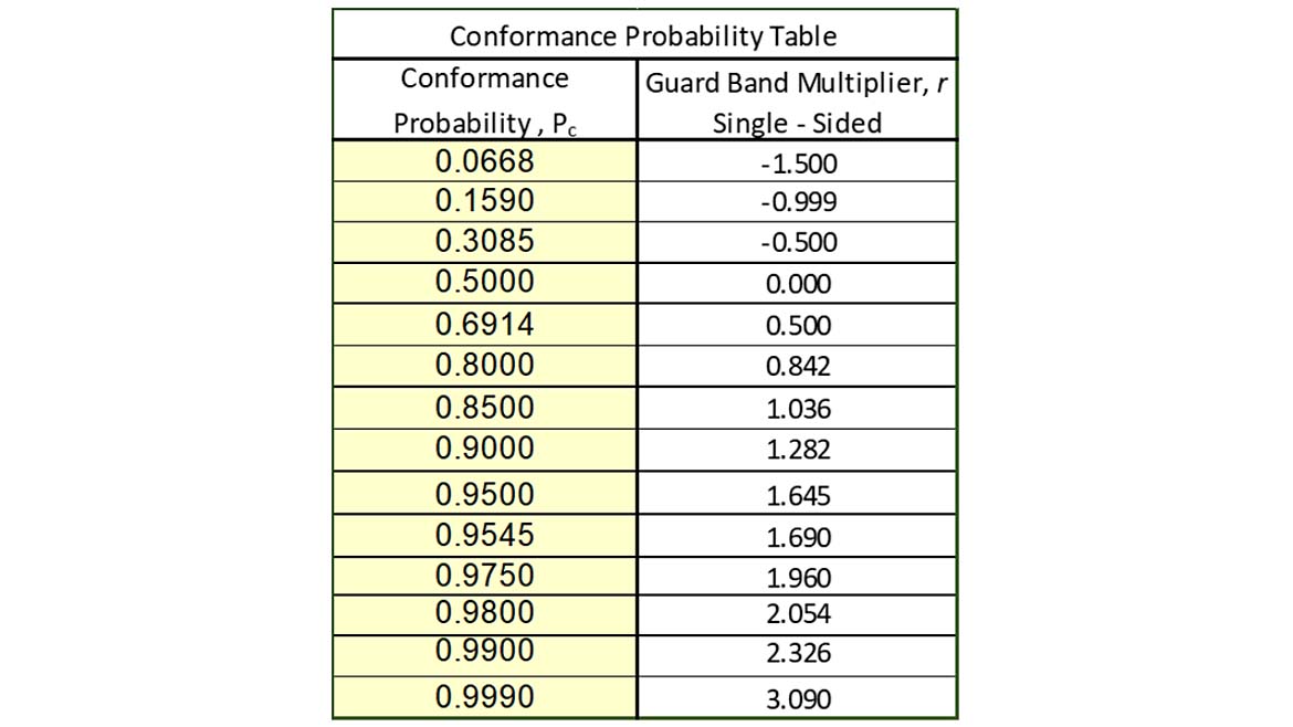

6.2 Method 5 (Specific Risk) Example: One-Sided Guard band
We are trying to calculate the acceptance zone using a guard band to limit our risk to a 5% limit between a lower tolerance and an upper tolerance. In this example, we use either -1 (Lower Tolerance Limit) or + 1 (Upper Tolerance Limit) units with a standard measurement uncertainty of 0.125 units.
Figure 4 Conformance Probability Table
Figure 4 Conformance Probability Table. Source: Courtesy Morehouse Instrument Company
We are calculating our Conformance probability for 97.50% Confidence using a single-sided tolerance. We calculate the guard band Multiplier using the Excel formula of NORM.S.INV(0.975).
Our Standard Measurement Uncertainty (k=1) is 0.125 units.
This Standard Measurement Uncertainty is applied as Expanded Measurement Uncertainty at a Coverage Factor of likely 2 to express an approximate 95% Confidence Interval, assuming infinite degrees of freedom.
Thus, we are calculating our Conformance Probability at 97.50% (100% - 2.5%) confidence. We calculate the guard band Multiplier using the Excel formula of NORM.S.INV(0.975), which results in 1.960.
We then use the number 1.960 as our GB Multiplier as follows.
If the single-sided tolerance is an upper tolerance:
For the Guard band upper limit, we have 1 – (GB Multiplier * Coverage Factor * Standard Measurement Uncertainty)

Figure 5 Max Risk Vs. TUR from Implementing Strategies for Risk Mitigation [9].
The reason this happens is related to how the decision rule operates. When TUR/Cm is low, the guard band gets wide, and the range where something can "pass" becomes very small. That means it’s much harder for anything to pass the test. Most items get marked as "fail," not because they’re bad, but because there’s too much uncertainty to be sure they’re good. So, the chance of wrongly passing something (false acceptance) goes down, not because the test is more accurate, but because nearly everything gets rejected just to be safe. This protects the customer but can unfairly hurt the manufacturer.
Figure 6 Max Risk vs EOPR from Implementing Strategies for Risk Mitigation [9].
The above assumes a worst-case TUR (Figure 6). When both True EOPR and TUR are low, most measurements lie outside of the tolerance, and the risk of falsely accepting an item is low. The false acceptance risk is low when EOPR is near 100%. It is less than 2% when the true EOPR is ≥ 95% (True EOPR is the actual value that is not assumed or modeled).
Therefore, applying just enough of a guard band to lower the maximum risk below a desired level is possible for a given measurement capability index Cm.

7. Flowchart
Figure 8 Measurement Decision Risk Flowchart
Figure 8 Measurement Decision Risk Flowchart.
