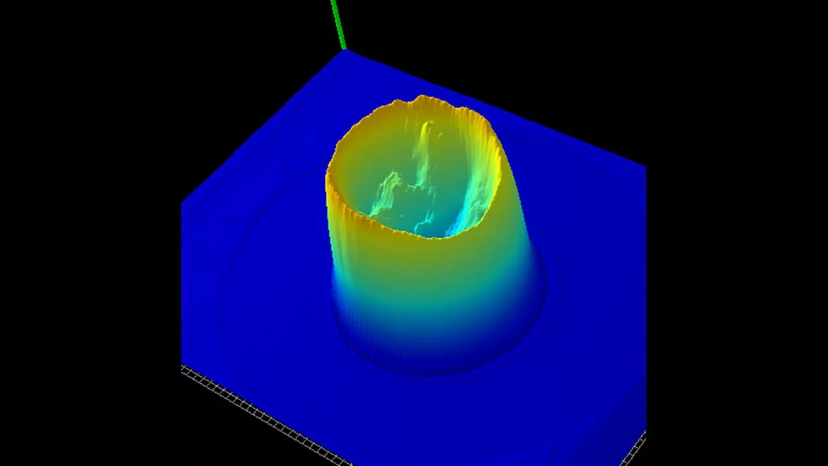

Imaging The Invisible
The nature of this packaging process provides an opportunity to use advanced imaging techniques to overcome the unique challenge of “seeing” a feature that is completely obscured. Because the foil in the seal is induction heated to create the liner seal, and because the temperature of the foil is key to the final seal quality, thermal imaging of the heat profile of the foil can be used to evaluate the sealing process. For this application a high-precision thermal camera with internal cooling was used to acquire an image of the heat retained by the foil in the seal shortly after the induction heating process. This “heat profile” is completely visible to the thermal camera through the plastic cap.
Evaluation of the thermal profile of the foil seal for all defect conditions though introduces additional application challenges. While some defects are clearly defined in the thermal images with features that can be extracted by geometry or contrast variations, other defects are more subjective and difficult to quantify relative to the typical “good” seal thermal image. The successful inspection in this application is accomplished by using a combination of analytical vision tools with deep learning in a “hybrid” analysis of the imaging.
QM VS 0322 Trends 3D rendering thermal image of good seal image 1
3D rendering of the thermal image of a good seal. Source: Integro Technologies Corp.

Deep Learning Enables Subjective Analysis
Deep learning is a subset of the field of machine learning, both of which fall under the very broad umbrella of the scientific discipline of “AI” (artificial intelligence). While machine vision applications have been highly successful for decades using “analytical” or “discrete” vision tools, deep learning has been proven to be able to successfully solve very complex classification and object detection problems with ease, particularly in cases where analytical algorithms can become prohibitively complex and large, and perhaps constrained in their accuracy when images contain highly subjective defects.
Narrow applications of deep learning in machine vision have become more mainstream as the accuracy of the results continues to improve with the help of better and larger data sets and better definition of the problems. Combining the strength of deep learning in this narrow sense for subjective decisions with analytical vision tools for clearly defined features results in a highly reliable hybrid approach to the analysis of the thermal foil image in this application.
A defect of particular importance is a bad seal resulting from a loose cap at the time of induction heating. The images of the thermal profile of the heated seal with a loose cap demonstrate wide variations, depending on the degree of cap looseness relative to the angular deviation from the expected position of a fully torqued cap. Traditional analytical vision tools do not achieve the required detection rate. However, this defect case can be defined as an independent, narrow failure mode and solved efficiently using deep learning rather than implementing a large deep learning solution covering all defect conditions. In this project, this hybrid approach resulted in an increase in detection accuracy for all failure modes overall, a faster delivery of a final solution, better scalability of the system, and improved inspection cycle times.
