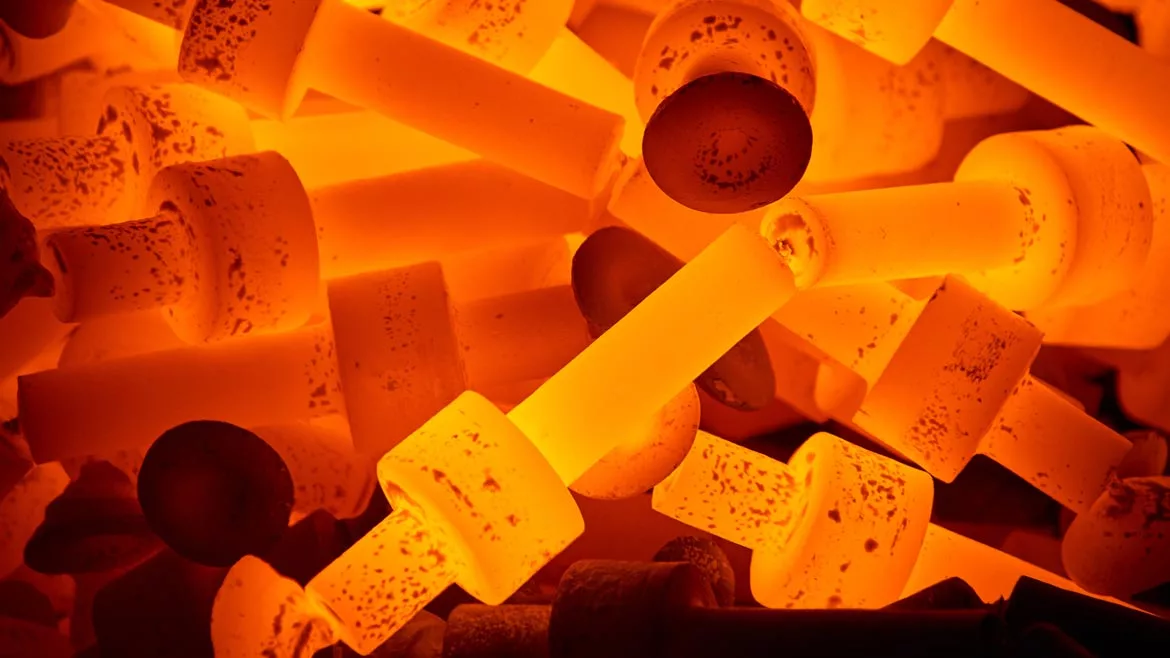

Residual stresses are those stresses that exist when all external loads/forces are removed. They are also called “locked-in” stresses. These stresses form when a part is plastically deformed by mechanical, thermal, chemical or a combination of these forces. In other words, almost anything you do to a part introduces and/or changes the residual stress state.
QM 1122 Materials Testing 04
Image Source: Adobe Stock
Tensile stresses attempt to pull the part apart, while compressive stresses attempt to push the part together. To compound the issue, residual stresses add to loading stresses to produce a total stress in the part. Keep in mind that stresses must balance to prevent the part from distorting or cracking.
The good news is we can use modeling to predict residual stresses. We can also control or intentionally induce residual stresses during the manufacturing process.[1]  In most cases, outer surface compressive stresses balanced by tensile stresses in the core can potentially protect parts from premature failures and extend part lifetime.
Any manufacturing process that moves, removes layers/sections of, or shapes a part changes the residual stress state. Common manufacturing processes such as casting, forging, welding, machining, grinding, stamping, and thermal treatments result in residual stresses. The final product is a compilation of the changes in stress that occur at each step of the process. Keep in mind that incoming stock also has residual stresses. Depending on the initial residual stress state and the changes that occur at each step in a process, some parts fail before the manufacture is complete.
