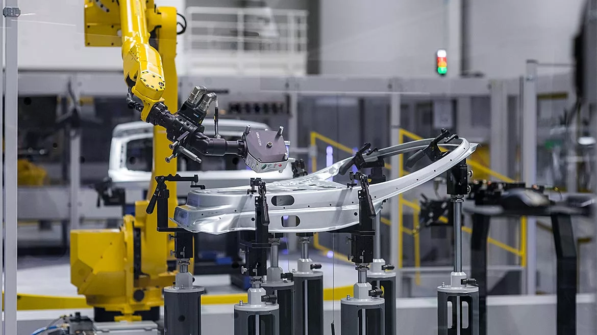

It is an exciting time for automotive design and manufacturing as all of our accumulated technology advances are being applied to the evolving frontier of electric vehicles. At the same time, carmakers are taking serious steps to push into this emerging level of metrology automation and embed these traditional laboratory quality inspections right down into their smart manufacturing facilities. These new systems are designed to measure mid-to-large sized parts and powered by the incredible accuracy of the latest laser trackers. Portable measurement combined with automation solutions gives manufacturers the ability to utilize lab-grade metrology technology on the shop floor in-line, near-line, and off-line. Supporting a variety of customer applications, laser trackers enable flexible implementations that include high-accuracy surface scanning, feature calculation and discrete point measurement that drive the highest level of quality into the manufacturing process.
These new-generation ‘scan cells’ are made possible by sophisticated software programs for robotic automation, metrology reporting and measurement data management platforms. Robotic automation software provides the toolset to efficiently plan, program and control robotic cells, as well as integrating with the wider manufacturing software ecosystem, simplifying the data acquisition process for smarter manufacturing processes. Created specifically to orchestrate the sensors, software and robotic equipment of an inspection scan cell from a single, intuitive interface, this software makes automated measurement more accessible, efficient and reliable. To maximize equipment utilization, an offline programming environment is also needed to provide accurate path simulation that allows virtual commissioning of the system and rapid deployment of programs to the real scan cell.
