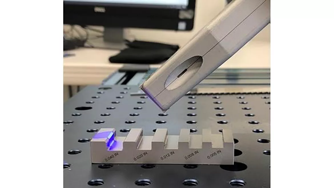

PSL metrology head measuring a chamfer on a machined chamfer and radius standard.
Figure 1. PSL metrology head measuring a chamfer on a machined chamfer and radius standard. All Images Source: 4D Technology

Portable, 3D Optical Gages
Optical gages are small, portable systems that provide non-contact, 3D measurement of features and defects. One specific optical gauge technology, polarized structured light (PSL), has been successfully measuring defects and features in aerospace and precision machining applications for nearly a decade, measuring defects such as pits, scratches and corrosion and features such as edge break, radius, and chamfers from 2.0µm to 9mm in height. The surface gage is similar to PSL optical gage but its technology is significantly faster and has demonstrated to reduce rework rates by up to 30% on critical engine components with its ability to correctly quantify defects. The underlying technology is vibration-immune, making it uniquely capable of using non-contact, three-dimensional optical metrology for measuring in extreme environments, including production and shop floors. These handheld systems measure in < 1 second—hundreds of times faster than manual inspection.
