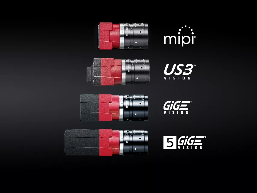

Allied Vision integrates Sony’s 4th generation 5.1 Megapixel IMX548 global shutter sensor with Pregius S Sensor Technology into its Alvium camera portfolio. With the new camera models, the Sony IMX548 sensor is now also available in Alvium cameras with either GigE Vision (Alvium G1-510), 5GigE Vision (Alvium G5-510), USB3 Vision (Alvium U-510), or MIPI CSI-2 (Alvium C-510) interface. The IMX548 sensor provides the same pixel size and resolution as Sony’s IMX547 but comes in a smaller, more affordable sensor package which makes the cameras slightly less expensive. With these additional models Allied Vision is offering a large choice of Alvium cameras with different interfaces and various housing options providing the very popular resolution of around 5 MP.
