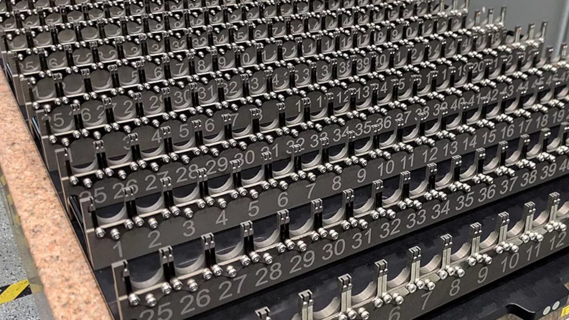

When designing inspection fixtures for high production injection molds the number and size of parts in the mold should determine the number of stations in the fixture(s). As an example, in a 16-cavity mold, it may be more efficient to build two 8-up fixtures – to have one on deck measuring while loading the second off-line. This method optimizes the runtime of the inspection equipment. Of course, the measuring area of the inspection equipment will drive the size and number of fixtures.
Standard Stops
Fixed (stationary) stops are used to locate the part consistently and are added to non-inspected features. Dynamic (moveable) stops may be necessary when there is little area on the workpiece to add a stop and that same area needs to be measured. This stop would be moved out of the way once a part is accurately and securely loaded in its station.

QM 0223 Test and Inspection 280 Up Custom Fixture
280 station CMM fixture built in segments for high production injection molded part. | Source: Phillips Precision Inc.
