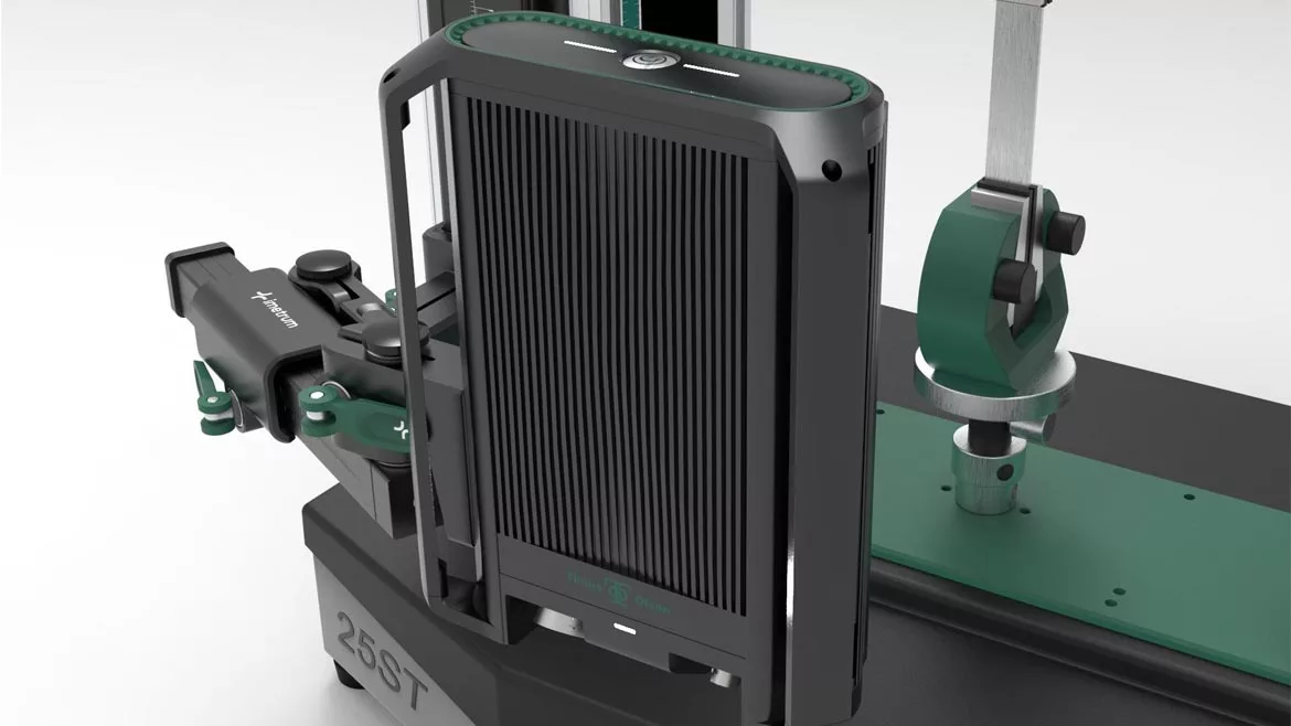

1 QM 0423 NDT Materials Testing Extensometry TO vector on UTM
Image source: Tinius Olsen

"This extensometer has a stereoscopic and volumetric system, with algorithms that allow measurements as fine as half a micron. It has a very quick and concise alignment process with lasers that allows for a finite view of the sample in the volumetric window that the device captures," explained Byrd.
"The technology is not strictly speaking digital image correlation (DIC) but it falls under the same general umbrella. It is the same principle in as much as it is tracking movement of a portion of the specimen by using DIC techniques, which is basically pattern recognition, recognizing the pattern frame by frame and tracking it."
"DIC systems have a sort of stress or strain map that looks a little bit like an FEA plot but this adaptation has an actual point to point measurement between two points on the specimen. So, as I said, it's not strictly speaking DIC but it's a very similar technology."
"As an example, elongation tells us a lot about a material but there are a lot of things that can affect this such as the speed of testing, the specimen, geometry, some different heat elements that may be generated, the surface finish of the sample that is being tested and the alignment of the device."
"As such, this step change in extensometry has integrated a very quick and concise alignment process, with lasers, that achieves a finite view of the sample in the volumetric window that the device captures."
'But one of the biggest step forwards with this technology is the speed of use. It takes away the need for time-consuming setting up and calibration of existing clip on extensometers," says Byrd. "It really is a case of simply plugging in and testing."
