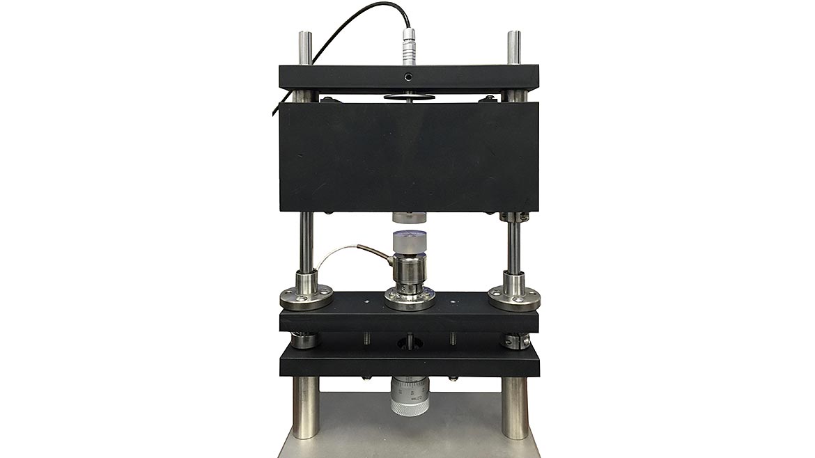

Figure 1: Side view of eXpert 4000 Microtester
Figure 1. Microtester with Dual-Opposing Crossheads and Heated Fluid Bath.
Image Source: ADMET
